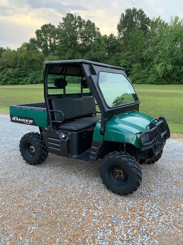

I have an Axis 500 4x4 UTV that I was given. It looks like an almost new machine with 39 hrs on it however it was apparently under water from the hurricane . I have no spark at the plug. I have replaced the plug, the plug wire, & the stator so far. Can anyone advise me of what i need to check and or replace to get this thing running? Any advise would be greatly appreciated.
