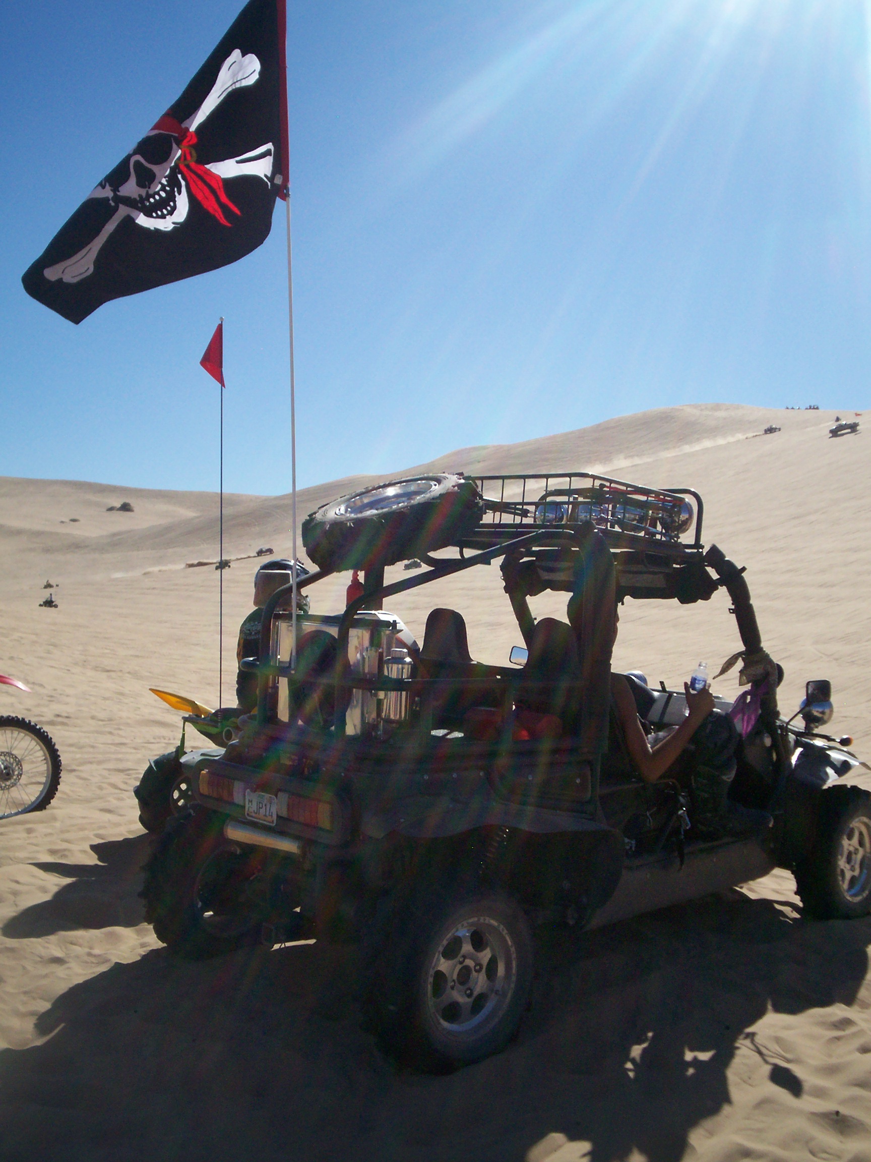

HI all! We love our Trooper T-2 (2008, one of the first 5000 but with the reinforced rear diff bracket)...We have snorkled the air and oil breather, moved the radiator up on the rear cage , added a top with storage rack, widened the fenders, a plexiglass windshield, nut and bolted the entire buggy, reinforced all electrical connections and anywhere a wire might rub, installed a muffler and waterproofed the underseat compartments. Also have a second set of "street" tires for when the knobbies aren't appropriate. We keep up on all the fluids and recommended maintenance and keep it garaged. Our next project is to raise the height and seal the fuse and ecm boxes and coat everything with die electric grease.
Our machine has performed well on the dunes of Glamis, the back country of the White Mountains of AZ (on the mtn. trails and the high desert scrub). We've even taken it thru the Little Colo. river wash near Holbrook a couple times (that was a blast!). We've gotten it really wet trying to dodge giant "puddles" during the monsoon season (which prompted the fender widening and the snorkeling). It has all the power and abilities to perform what ever we ask of it. (we've even raced it in some 1/8 mile drags.) It outruns/out performs the other more expensive UTV's our friends have, especially in hill climbing and endurance categories. We don't dare jump it....wouldn't want to break any suspension components, not alone the diffs or an axle.
Besides the fuel pump falling off (the first week we owned it), the end of the muffler blowing up/off (towards the end of a 150 mile hard ride), a bit of an overheating problem (solved by raising the radiator), all the boots deteriorating/cracking, the front end steering gear being really sloppy, the lights konking out on a night ride on the dunes, several quirks in the electrical system (even before getting wet), we still enjoy our Trooper. But, We never leave home without a well stocked tool box sitting in the back as one never knows what's going to happen next. ;)
