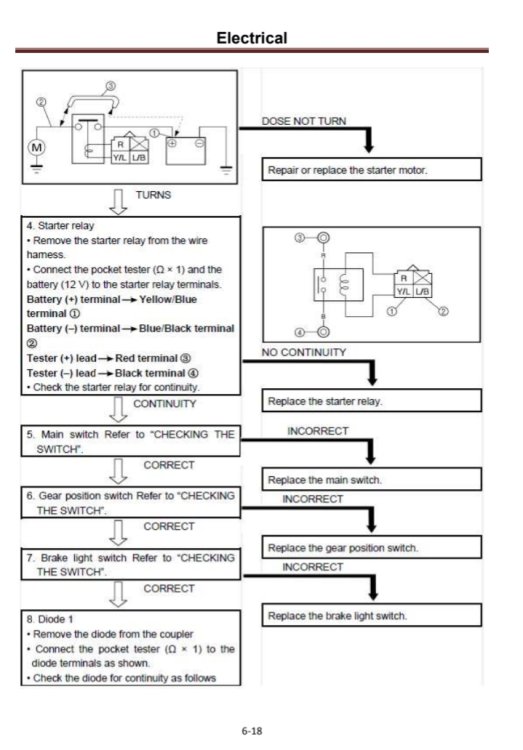

Yep I have power to dashboard. Press brake to start. Unit can be in any gear. Unit runs when I power the starter solenoid direct. Apparently a sensor is not recognizing when brake is depressed. Maybe a switch at the master cylinder?
The brake switch is above the pedal. When you depress the brake are you getting brake lights? If so it's fine.
When you jump the solenoid it will bypass the safeties,  it needs to be in neutral to start.
You never mentioned if you are getting the "N" neutral light on the dash before trying to start.
Here is the page from the service manual, Since we know it starts when jumped I skipped the page checking the wiring.
Basically check the brake light switch, neutral swich, and testing procedures for the solenoid (item 4 above).
