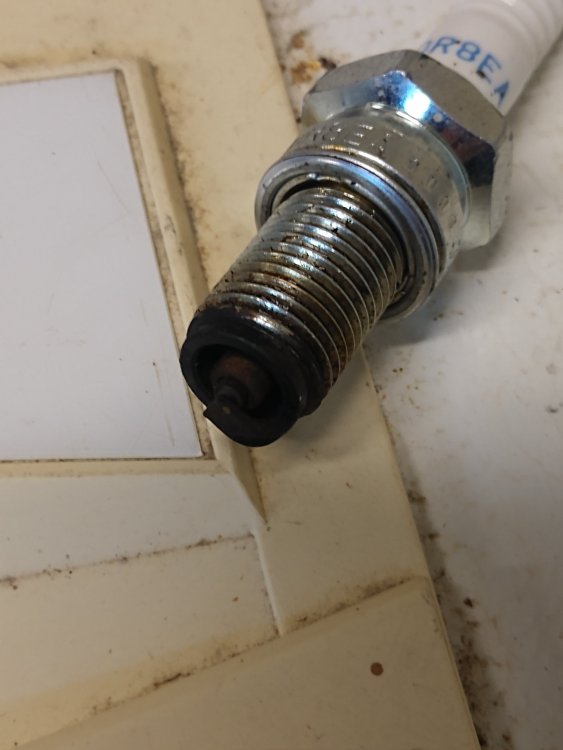

When I took my plug out it was toast, changed it last summer. You can see it's running rich. I put it back together and it fired up a lot easier with new plug, but I know the valves need adjusted there is 5900 miles on it. So there is only two valves intake and exhaust, so if I have my pistol dead top of stroke with valve up then it's ready to loosen and adjust, then repeat for next valve, I just want to make sure I don't want to do something wrong and it won't run. Probably don't need the part's I ordered but I will keep them. Here's picture of old plug.
