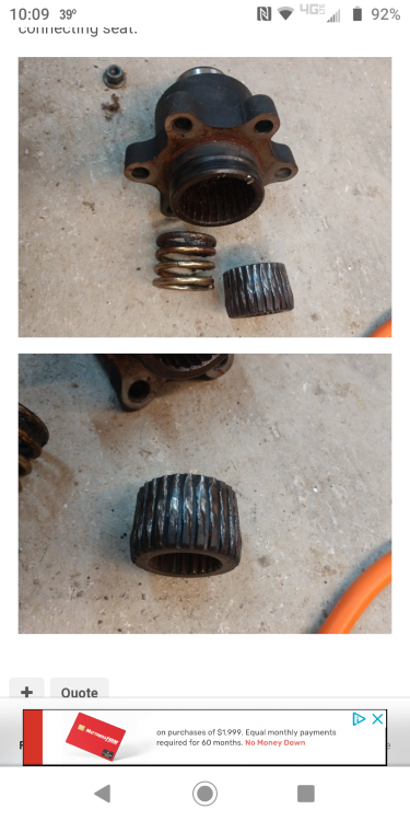

That gear shouldn't be sticking out, when you put Greece in your driveshaft it will expand, but I got a hisun sector 550 that was put together wrong from factory. Mine had a spring behind the nut in the differential, only way to know is remove driveshaft and look at that gear, and make sure they didn't add a spring behind your nut, it will keep that gear from going all the way in. That's probably about the same amount of miles on mine before it happened to me, here's picture of bad parts, don't put the spring behind the nut if yours has one behind it.

Your welcome, if you look what you got sticking out, it's about a perfect match to mine gear you see what was sticking out. Should still be under warranty, hisun will give you the parts for free if you take it back where you bought it. But could take months before you get it back. Those two pieces isn't that expensive. But hisun knows some utvs went out that way. I bought mine in 2019 I would of thought that problem wouldn't happen on new models. I got 5900 miles on my now and it's running good, just had to adjust valves last week because they got tight.

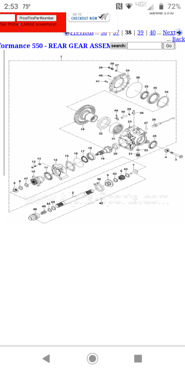

Yes, but the splines inside that housing is probably stripped, the spring behind that nut doesn't belong in there, throw it away. Here's a diagram

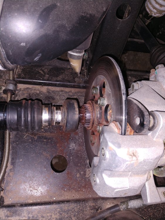

Was a warm night for the 1st week on November 69° so wife and I took out for one final night ride of the year. Was going up dirt hill and started making a popping and grinding noise. Had to put in neutral and back down to a driveway to turn around. Wouldn't pull out. Had to kick in the front axle. Drove back home by front axle pulling us 3-4 miles. Once home had wife put it in reverse so I could see what was happening. The driveshaft wasn't spinning. Just moving back and forth about 1/8 of an inch.
From diagram looks like part 46 is a coupler also.  I don't have a local shop and seen a request form for a mobile tech on the axis website.

46 is the rubber cover to the driveshaft splines. theres another post right below this you you likely have the same issue, the splines on the driveshaft stripped out. I've seen a couple other similar older posts with the same issue.
Pull the driveshaft and see how the splines look.
