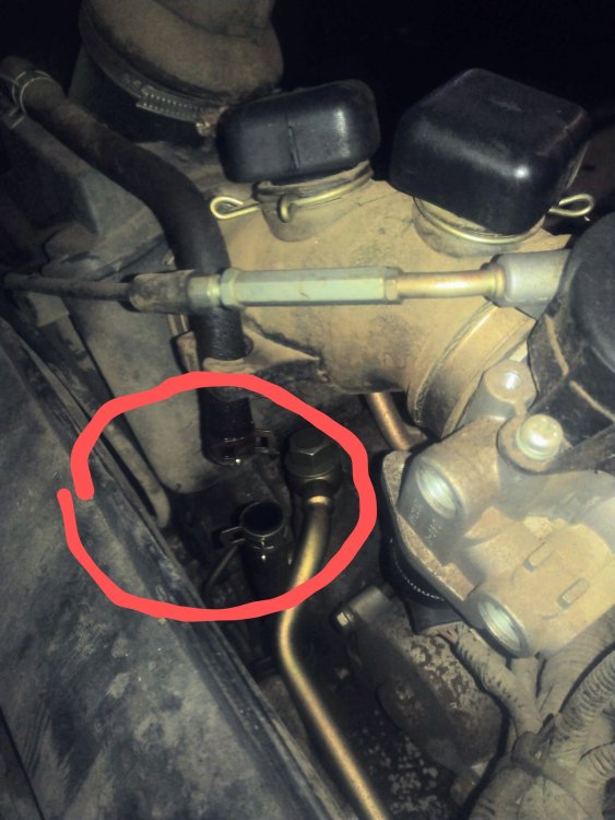

It  just a crank case breather. You could do several things, put a small air filter on it (to keep oil from getting all over the place or plug it into your air filter box.
We have a hisun 700 and had same problem, the part was missing. As others mentioned its most likely some sort of air/oil separator or oil catch. I just connected the two hoses together as the upper one in my case opens into the airbox. I didn't encounter any problems with oil plashing into the airbox after I connected them, but check a few times just in case if you do decide to connect them. I think that may have been the reason why there was oil splashed all over the top of the crank case but I can't remember. Looks like you have oil splashed all over too.
