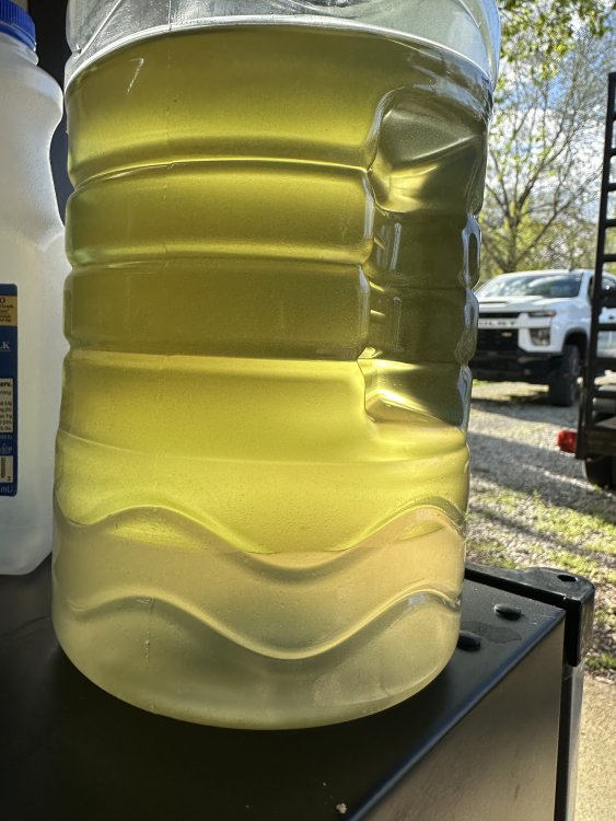

Not even sure what it was, looked like lemonade coming out. The bottom of the jug appears to be an oily substance like cooking oil. What’s odd is the machine would start up then die every time with this in the tank. Back to running like new once we drained the tank and line completely and put in fresh fuel.
He was given 5 acres by the owner of the property probably 20 years ago. The owner has since passed and his son and I take care of the place. This guy has gotten progressively worse since his passing. What sucks is he’s always there and we’re an hour away. We had a disagreement over him bringing someone else in to hunt the night I believe this happened.
