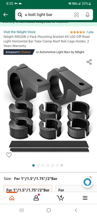

Upon researching an LED light bar, I see if I get a one-row bar, that is really easy to hook up.  Plug n play, pretty much.  But there is no place to mount a light bar on the front because it's all rounded framework!  And you can't mount one up above the windshield, because that is all plastic!  So where would you even mount an led light bar on this Coleman UTV400?????  God I wish I had someone to come and help me!  I just need someone to SHOW me once, and then I could DO the work myself!  But I am ignorant on this stuff.
630018299_Screenshot_20221215-203531_AmazonShopping.thumb.jpg.a2cadc7bacc049f1489728c3905b9e8d.jpg
You get something like this to mount the light bar to the round tube.
You can mount the switch anywhere you can get wires behind. The spot you mention is the ugly for where the ignition used to be on the older 400s. Should be doable.
You will need to run wires from the battery under the seat, underneath the body up to the dash and up to the light bar. A pack of zip ties will be needed to attach the wires so they don't just flop around and chaft on stuff or catch on things.
Order a kit with the wiring harness and we will be happy to help you get it all set up. I know it looks daunting but it's a lot easier than you think and most people are more than capable of completing the project with a little guidance.
The best way to learn this stuff is by doing it! You've got this!
