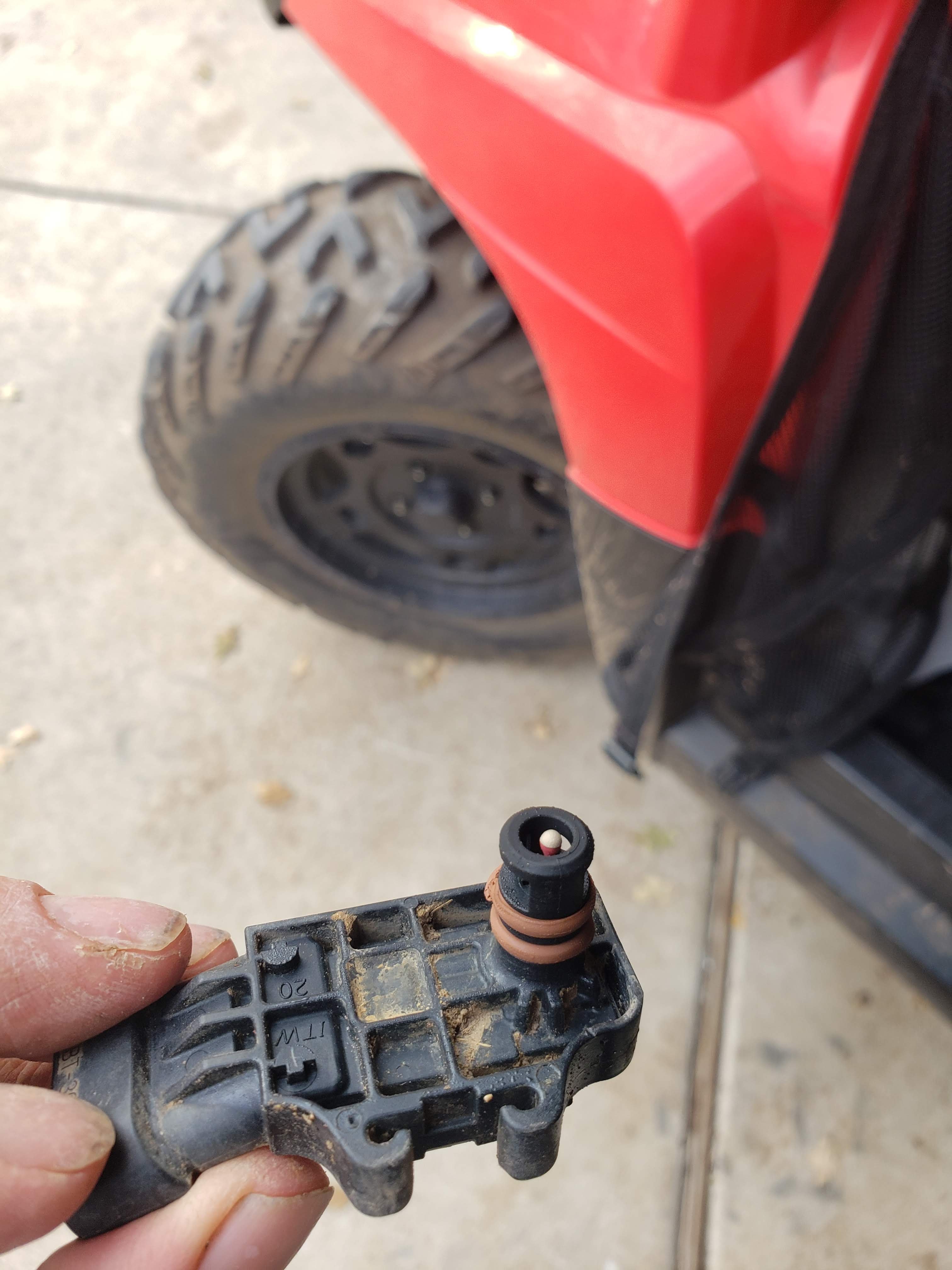

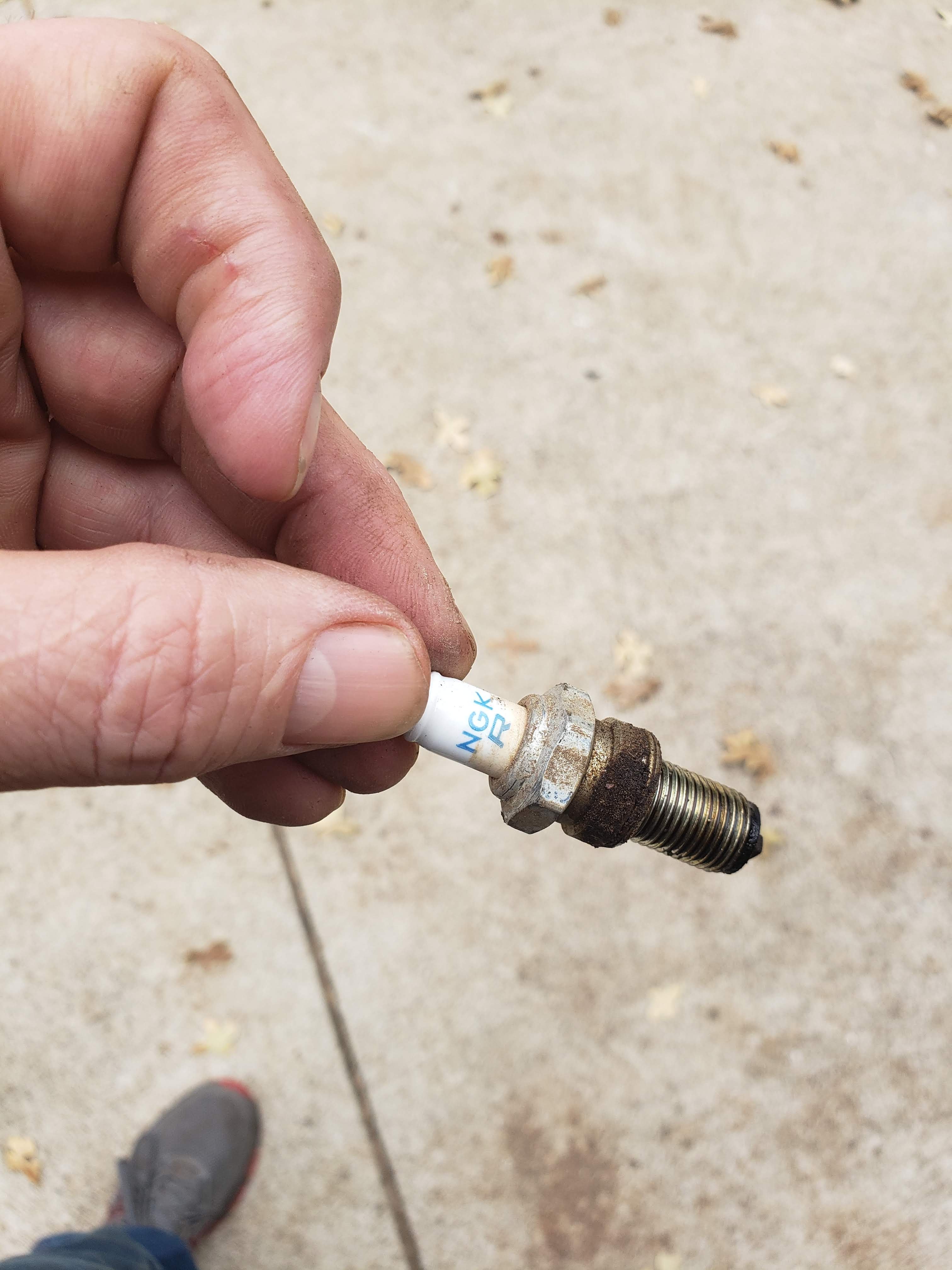

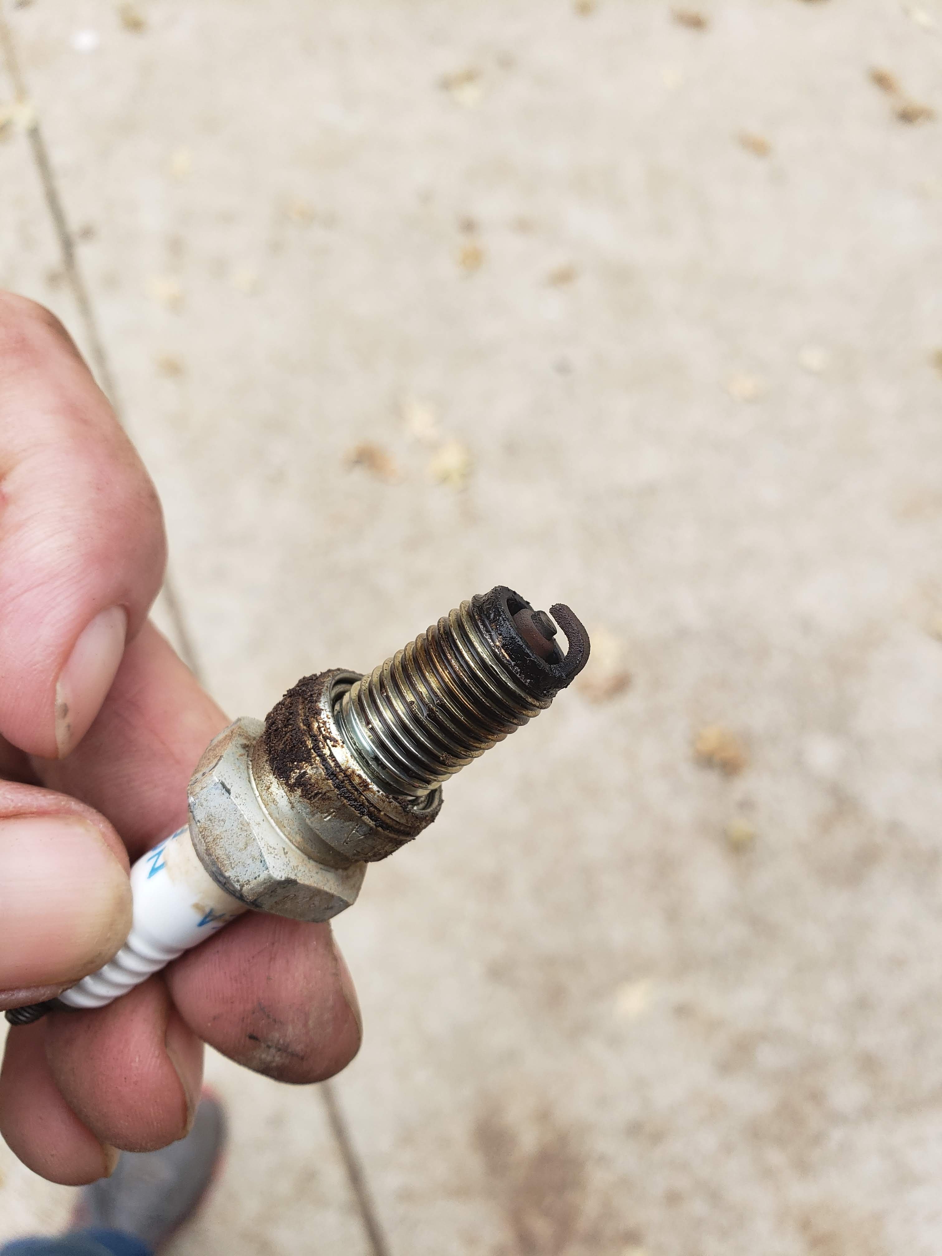

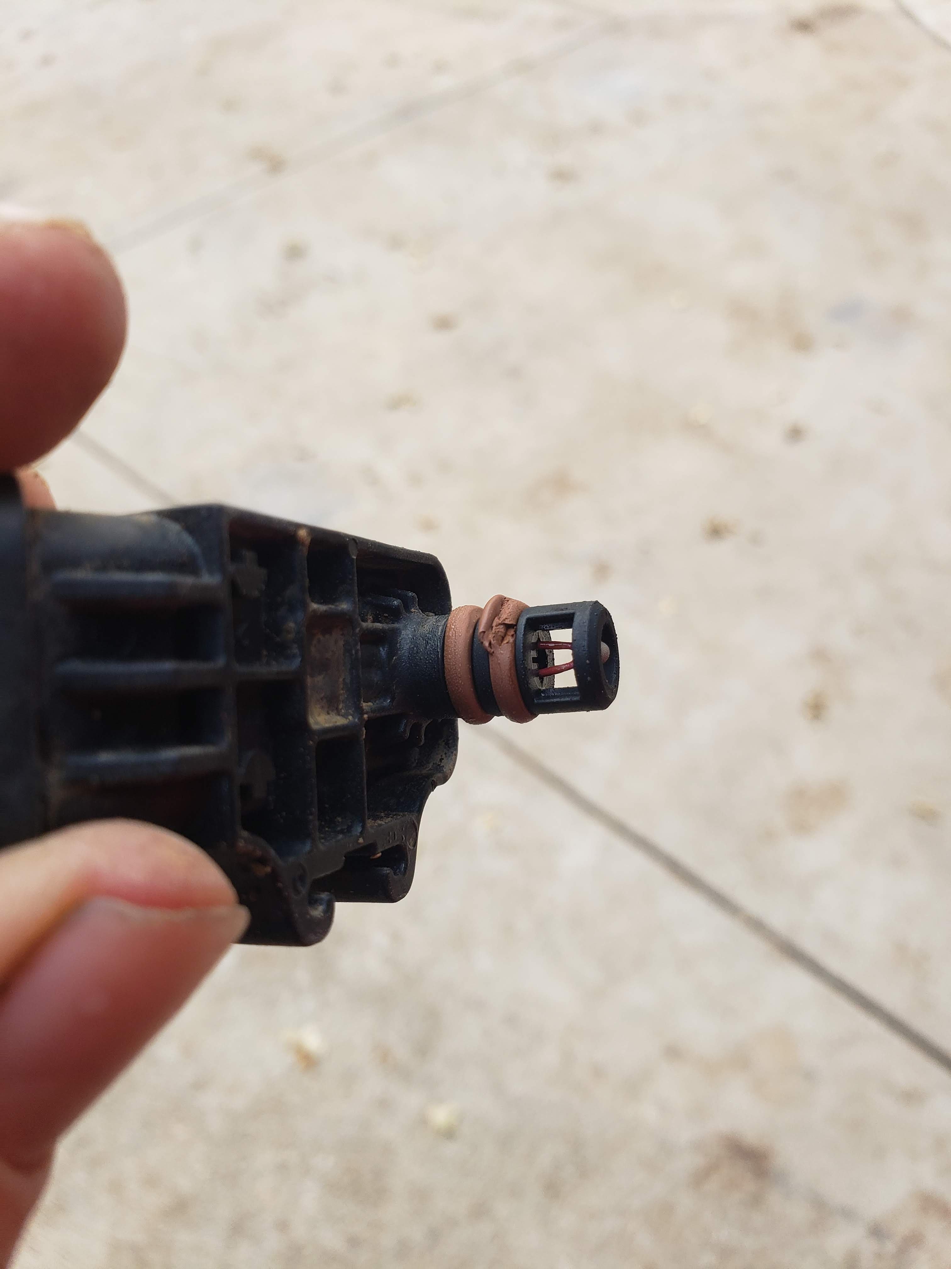

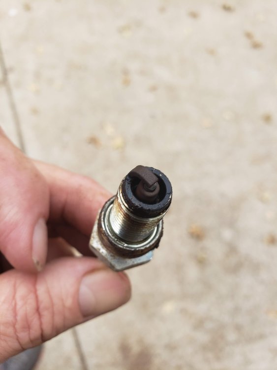

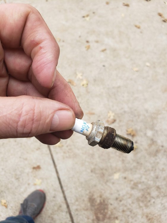

I'M STILL GETTING BACKFIRE UPON DECELERATION: 2 days ago, Strike was very sluggish, wouldn't make it up a hill. It is EFI with under 200 hrs. Yesterday, I replaced the plug with same exact I took out (NGK-R DR8EA), as it was covered in black soot. I cleaned the MAF with MAF Sensor Cleaner - not sure if I ripped one of the 2 o'rings pullling it out of it it was like that but either way, when I put it back in, it was seriously tight so I don't think that's affecting anything. I cleaned some of the throttle body (without removing it and without touching the flap), with Throttle Body Cleaner - it was kind of dusty. I cleaned the air filter which I replaced just 3 months ago when I did the oil change. All connections seem to be good. I could not find any exhaust leak anywhere. It got dark on me but I took it for a spin last night after putting it all back together and it seems to have it's power back but it's still backfiring when I decelerate quickly. Anybody have a clue what's next or had this issue before? TIA.
There's no MAF it's a MAP/intake air temp (pressure as opposed to flow) sensor. I would replace that torn up o-ring and lightly lube them with silicone grease (avoid regular petroleum based grease as it can cause the rubber to swell)
Since you've already replaced the plug and checked the air filter, have you ever checked the valve lash? I would start there. If the valve lash is in spec I would check the injector next, it may be partially plugged.
It's also possible you have a sensor feeding bad info into the ECU which would effect fuel mapping, like the sensor noted above, but aside from fixing the orings that will be harder to track down.
Thanks for the info! Just ordered the o'rings, new fuel injector and inline filter. Will check the valve lash and then put these in this weekend and see which one does the trick. Fingers crossed! Thx again!
