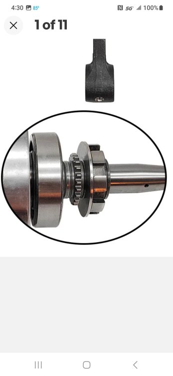

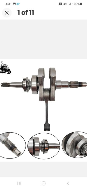

Unlikely that its bent.  The crankshaft is too narrow as you can see on pictures. The sprocket is pressed in and the hours are under 200. No reason for that to bend. Hisun suggested new tensioner and tensioner guides but even those look brand new.

Ever get anywhere with this? I’m having similar issue, engine jumped timing and won’t run. I can spin the cam, the timing chain turns, but the crankshaft doesn’t. I was actually able to screw around and get everything longed up again and got it to run for 10 seconds. Everything looks new, that I can see. Worried gear on crank issues. Only 4 years old and couple hundred hours on it. With it being a press fit, I’m thinking no way to replace with engine installed. Hope you got yours running again. Mines been down for a few months and momma wants it back running. Maybe I’ll just drop a 5.0 coyote in it. Lol
