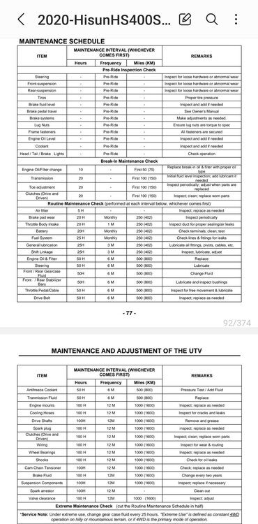

Straight from the FSM (available in the downloads section)
Service intervals:Screenshot_20240405_172921_SamsungNotes.thumb.jpg.309cad44e0f9031a43bb4b274a493e79.jpg
So 10hrs/50 miles for breaking. 100 hours/500 miles for regular oil changes per the manufacturer.

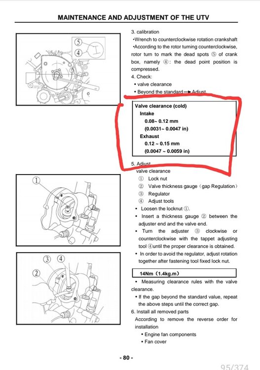

Valve lash:
Screenshot_20240405_173001_SamsungNotes.thumb.jpg.4090ad53fd79af2fa516a0d95d324c89.jpg
