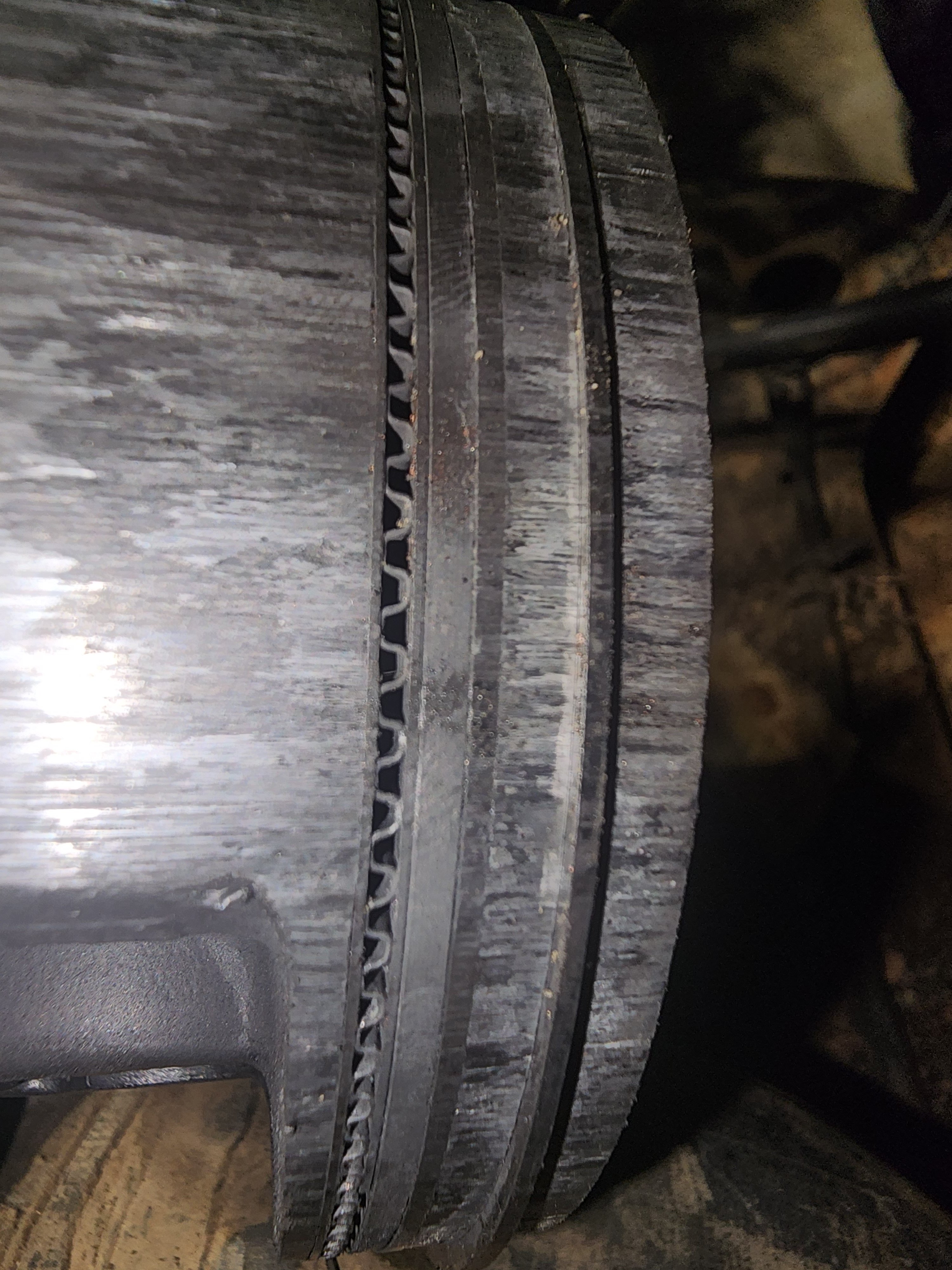

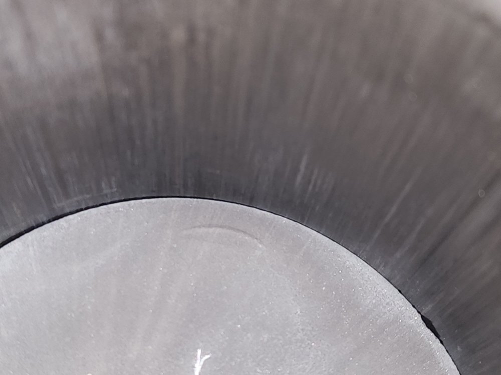

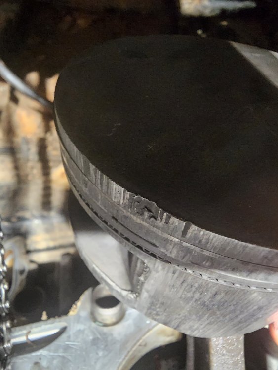

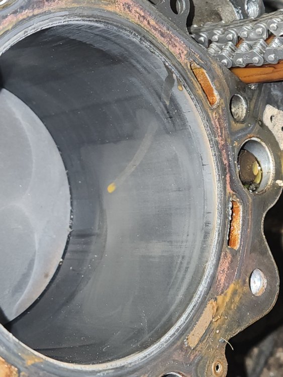

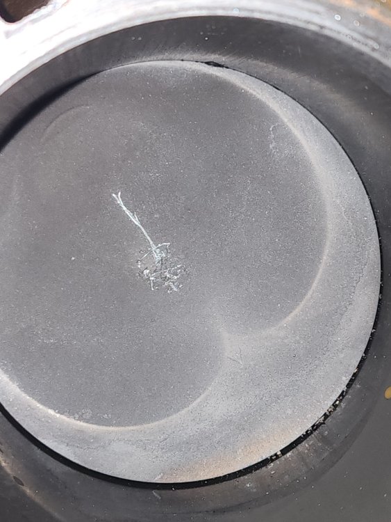

I did a compression test and was only getting 30 psi. I found that my piston head has insufficient lubrication and/or overheating. I posted pictures to get any thoughts on replacing bore or just have it hone. I know my piston head definitely needs replaced.
