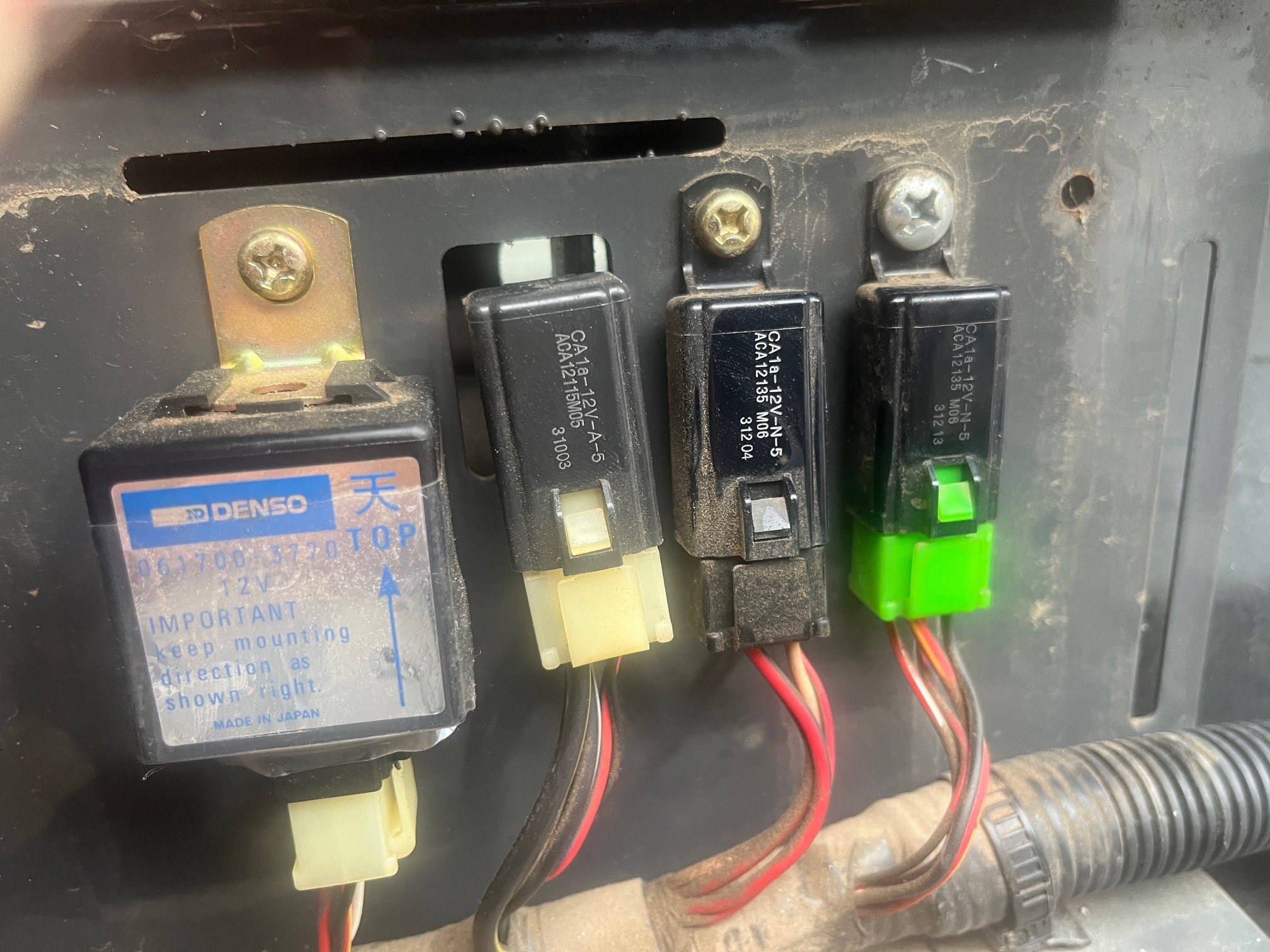

I am still not sure about the fuel shutoff solenoid shown in your replay - it engages and moves when I try to start, and then disengages after the engine dies....perhaps it is not opening far enough? What are the relays shown in the attached picture? Could any of those be an issue?
