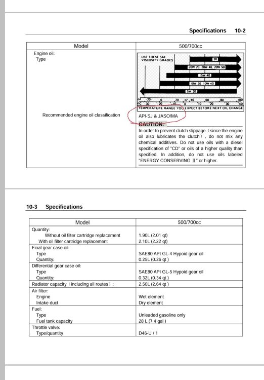

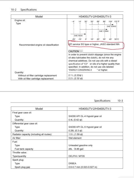

This is correct JASO MA oil is a requirement for wet clutches, other motor oils are "Energy Conserving II" and will cause wet clutch slippage, and rapid wear.
The manuals I've seen out of Hisun/Coleman are not explicit or don't mention it at all.
From Coleman 400 manual.
From Hisun 500 manual.
