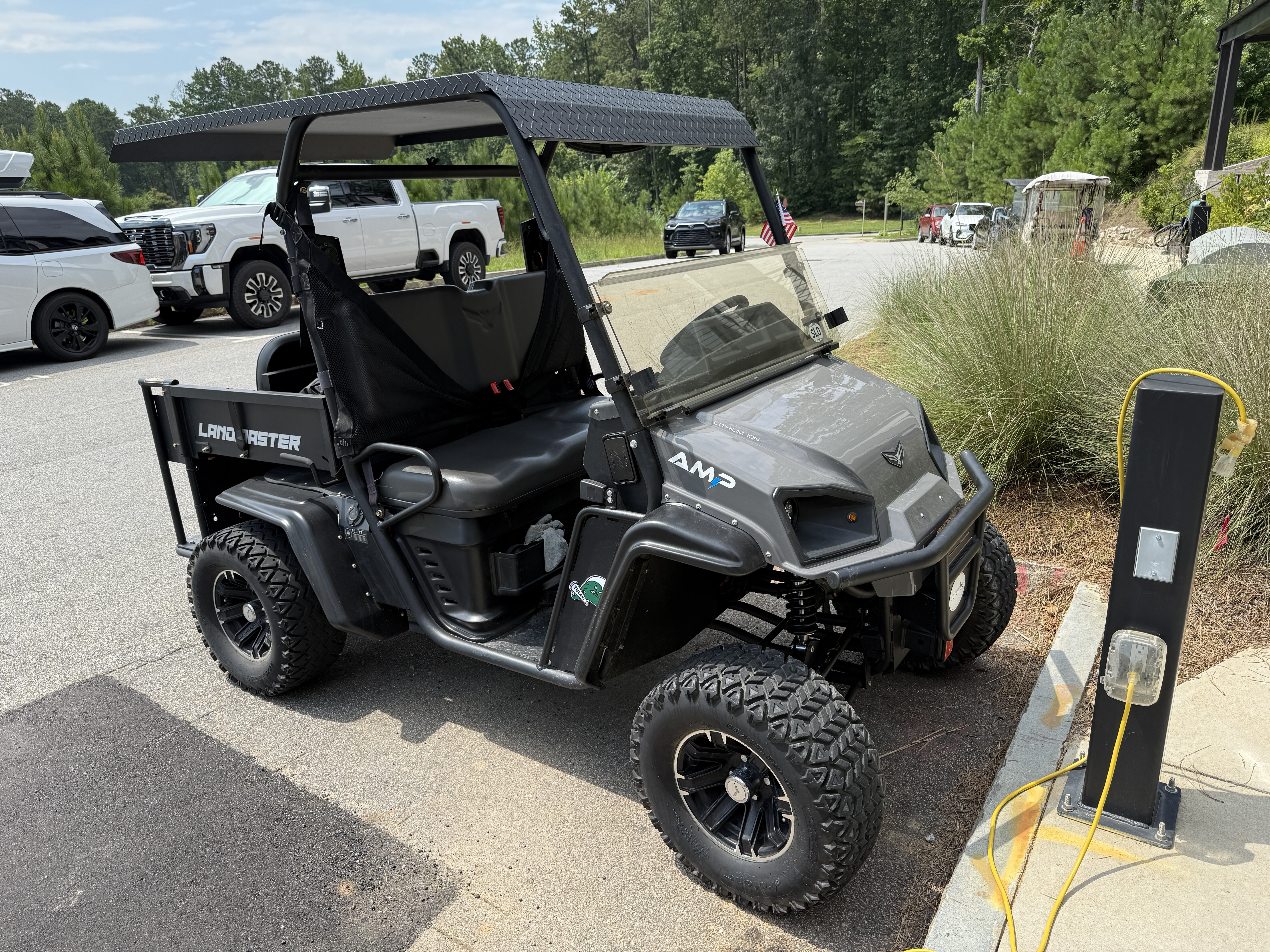

After about 9 hours of use, happy to report that things are going well.  The huge (for a UTV) bed is a serious productivity enhancer.  I can cut and haul soooo much more slash than I used to.  The electric dumping feature is pretty great, too.
I was wrong about the motor.  It’s rated at 24hp, not 25 as I mentioned above.  The power is plenty for my needs.  The torque is noticeable.  The on-demand 4x4 is pretty useful as I experienced when stuck on a steep and loamy incline.  Switched it on and immediately achieved traction.
The front and rear hitches, along with the winch, make this a very handy extraction vehicle.  Tree saver and snatch block setup is a breeze.  I use it to pull gamble oak after thinning an area.  Anything I can’t pull by hand with an extractigator I am able to pull with the winch.  The included winch hook is pretty poor.  I’ll be replacing it.

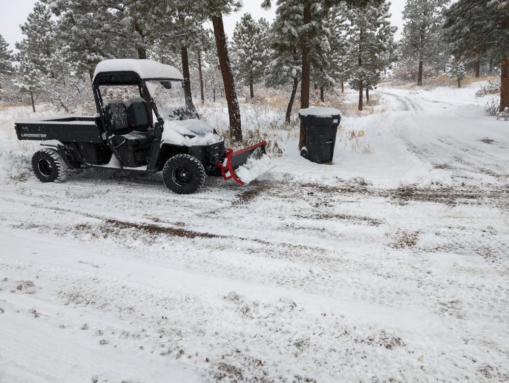

First snow of the season came Saturday and it snowed through the night into Sunday.  We only accumulated about 10 inches on the deck and 6 on the driveway.  The temp was 8F when I turned the machine on and started plowing.
This was my first time plowing ever.
Observations
  • No problem with the battery in that temp.
  • Plenty of power.
  • Great traction on my asphalt millings driveway.  Doubt I'll need chains.
  • The controls for plowing are decent, but not conducive to multi-tasking the operations of plow up, plow down, switch from FWD to RVS, and steering input.
  • Working the pedals with insulated boots on is a poor experience.
  • The hydraulic plow from Landmaster is beefy and laying a long stripe is very effective.
  • It's much warmer sitting in the cab, even without a heater or doors, than walking behind a blower.
If I had to choose between plowing and snow blowing 6 inches, I would choose the blower.  When I get over 12 inches, I will turn to the plow.
