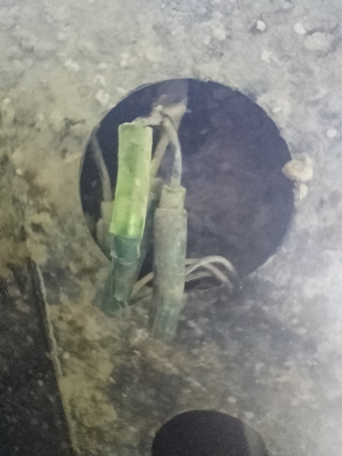

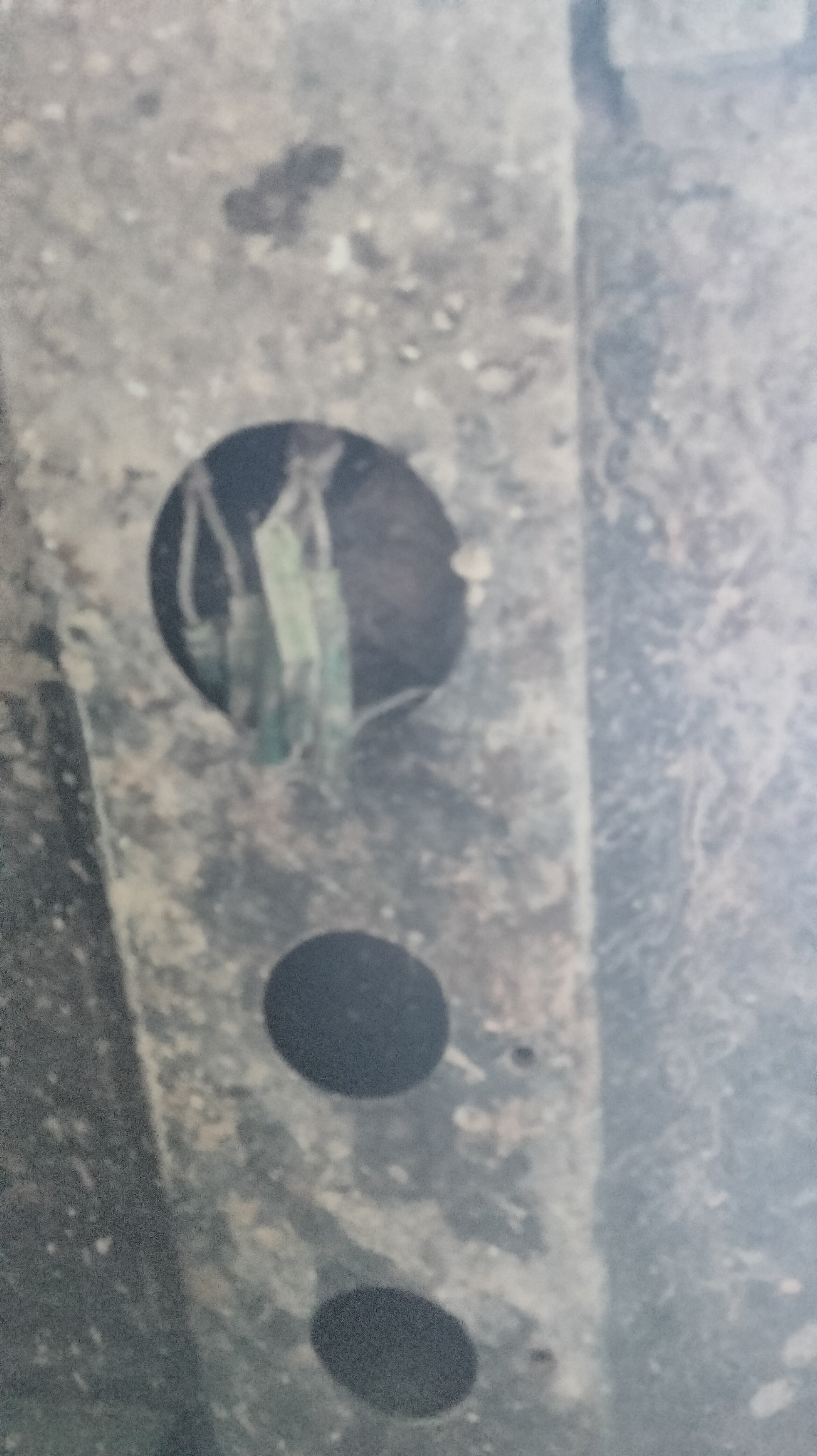

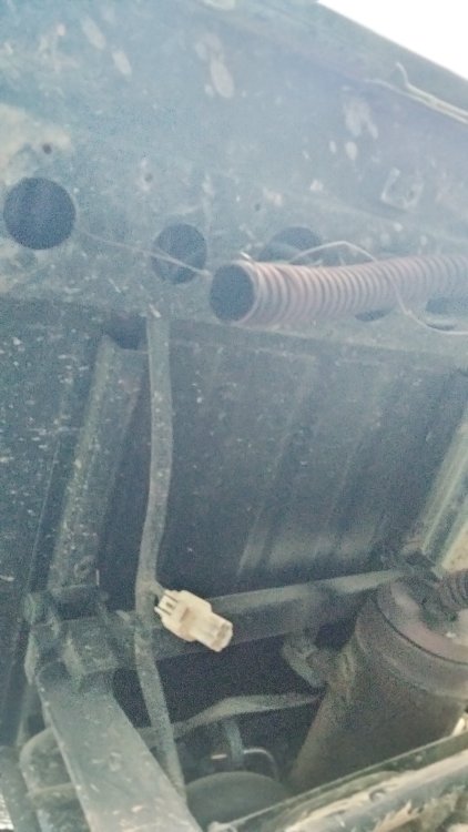

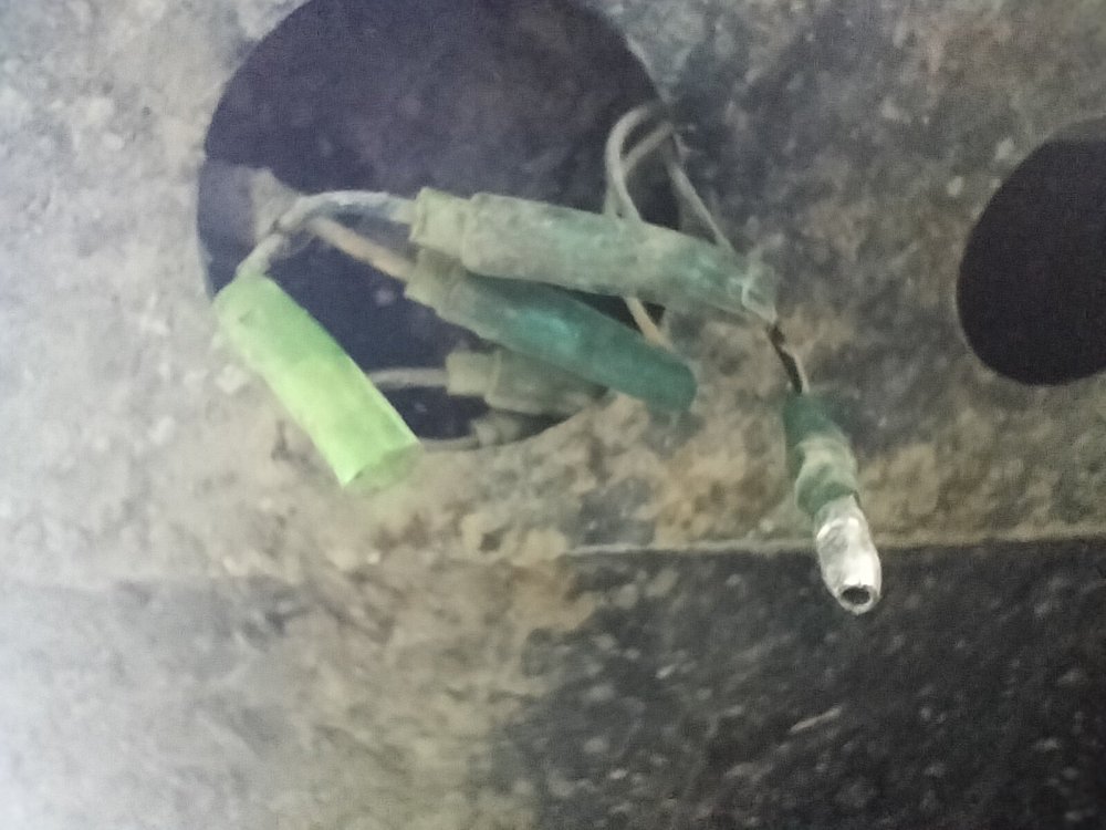

I'm going to GUESS the connections for the lights at the back of the dump bed are not connected. There are clip connections there for the light on either side of the bed. When I had to remove my bed, I had to undo the connections.
If you are not comfortable messing with the connections. Then I recommend waiting on the mobile tech. After all the machine is under warranty. Or you may want to look there. They are up in a kinda hard to reach place. It's just starting to get daylight outside. I'll see if I can get some pics of where and what to look for. The schematics that Andy mentioned will help troubleshoot.
On 10/23/2023 at 7:41 PM, Greg Kilgore said:
Here are some pics from my Axis 500 of the light connections under the bed.
IMG20231023183118.thumb.jpg.442d793c27b91a600205917819dc8d39.jpgIMG20231023183221.thumb.jpg.77ac6f99bb7a26819e0108ea22858aab.jpgIMG20231023183248.thumb.jpg.b76361b559902739a336598c50251047.jpg
IMG20231023183107.jpgThat connector is it for trailer lights? or is there a place to hook up trailer lights?
