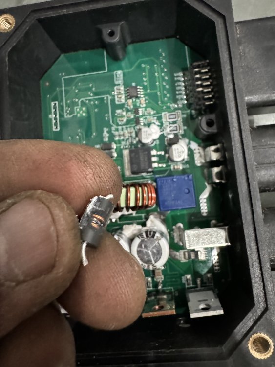

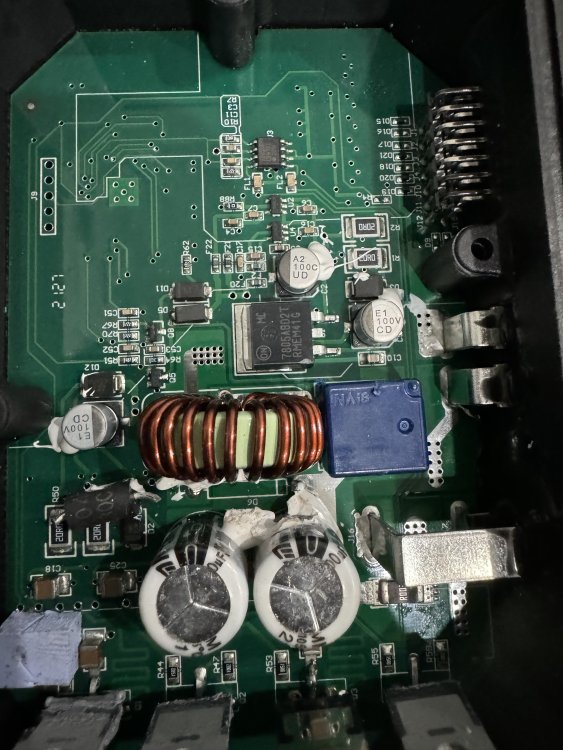

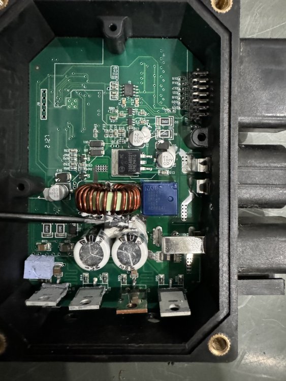

I have a 2022 hisun sector eps 550. 30amp fuse is blown for eps. Checked the motor and it’s fine. Opened up the controller and found a bad diode. Dealer wanted 500$ for the controller. Just posting this in case it helps someone. I couldn’t read numbers from the old one so just took a guess and replaced it with a 100v 3amp diode. IMG_1137.thumb.jpeg.28bcd42ebf6fc05c1c5a203e85b6960f.jpegIMG_1137.thumb.jpeg.28bcd42ebf6fc05c1c5a203e85b6960f.jpegIMG_1138.thumb.jpeg.2cc4c00fa3e92c57f643e939462a3f46.jpegIMG_1139.thumb.jpeg.af69614ed2870eeeebab64e8c56edaf6.jpeg
I have a 2022 hisun sector eps 550. 30amp fuse is blown for eps. Checked the motor and it’s fine. Opened up the controller and found a bad diode. Dealer wanted 500$ for the controller. Just posting this in case it helps someone. I couldn’t read numbers from the old one so just took a guess and replaced it with a 100v 3amp diode. IMG_1137.thumb.jpeg.5f354c3c8c0a99dabdd468363f7018ee.jpegIMG_1138.thumb.jpeg.a362d65ec8d7285cf9169538cff061c3.jpegIMG_1139.thumb.jpeg.1a83a5e3798dd817326355cdf023e6bd.jpeg
Hey, thanks for the info. My 22 rk 750 has had no eps since about April or May, just turned dead left if you let go of the steering wheel. No help at all from hisun in Texas other than tell me to take it back to rk after the mechanic had already  told me twice he had no idea what was wrong with it. Had to have a starter replaced at another dealer closer to home and they said they would check on hisun fixing the eps.  Been about 2 months and haven't heard anything. It's a decent sxs when it works but I would advise anyone to buy another brand and save a huge headache.  Where is the diode located and does it just plug in? Thanks for the info. Sorry you're in the no eps club.
Hey the diode is in the eps module. And it has to be desoldered. Module is located behind the airbox. It’s the one with three plugs on it. Is your power steering malfunction light on ?
It does have a code, F0001 and the red steering trouble light is illuminated on the instrument panel. Did your steering wheel turn all the way one way or the other when you let go of the wheel? Mine turned all the way to the left. I called and tried to buy a service manual not long after I bought mine in 2022 but hisun in Texas wouldn't sell me one. Dealers and authorized repair shops only. Paid over 400 to replace the starter because it dragged all the time. Rk mechanic said they all start that way. Any help would be greatly appreciated. And thanks for the info.
