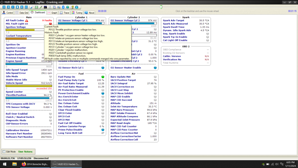

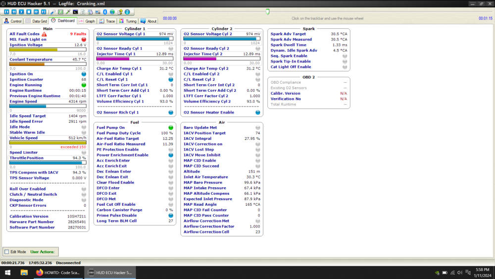

Got the cables ordered and ECU Hacker downloaded. Tried starting it and like usual it would stay running. I unplugged the TPS and it started but the RPM's raised to about 4300 RPM. Here is a screenshot of What it was doing. Not too sure where the parameters need to be on these. It seems to be pointing to the TPS since anytime I unplug it, it stays running. With a new harness and TPS I'm not sure why. Is there any calibration I need to do for the TPS and/or the AIC? There is also a screenshot with the fault codes.

You can use the software to clear all the old error codes and start from a clean slate. If the TPS continues to fault out it could be a connection issue i.e. a pin in a connector pushed in creating an open. If you leave the TPS in will it still throw the TPS error code?
The TPS is nothing more that a potentiometer and you should be able to check it with a volt ohm meter. It should have three wires going to it 12V from the battery, center tap that goes to the ECU and ground. The ECU uses the center tap to determine the position of the throttle and adjusts everything accordingly. I would check the TPS with the key turned on and use volts on the meter. Place one lead on ground the other on the center tap then press the throttle and the voltage should change incrementally as the throttle is pressed and then return back to the idle setting. You can find a schematic on this page at the bottom https://motorcycledoctor.com/parts/utv-700-bucket-seat/
The other thing to consider is that the IAC is sticking up inside the throttle body due to build carbon buildup. Even if you replaced it and there was build up the new one would stick as well. If the IAC sticks shut it won't idle and will only stay running if you give it throttle. Mine stuck again a month ago but is ok now. I'm going to polish the end and clean up side the throttle body with the spray carbon remover. I might even put a little dry lube PTFE on the end after I polish it.
I did clear the codes and they came right back. I'm not sure why so many codes are popping up especially since I've replaced everything. I did check the TPS and the voltage and resistance were good. I did replace the IAC and also cleaned the throttle body. When it shuts down I can hear the IAC reset so I don't think it's sticking. Also when I unplug the IAC it won't run at all. I'm not sure if there is a need or a way to calibrate the sensors, other than resetting the ECU.
This is really pointing to something common like a wire, either ground or power. It's pretty much calling out codes for all of the sensors that provide information to the ECU. If you look at the schematic I gave you a link to, look for a common wire connection or possibly a loose or corroded ground wire. For all the codes to come back there has to be a common source. A no signal and low voltage warning indicate no voltage present or a missing ground i.e. a lack of reference to ground.
