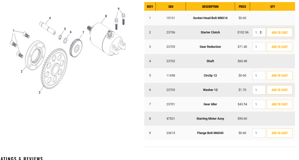

The gear marked #3 in the diagram should turn freely in one direction, but not in the other direction. If it won't turn in either direction, you've found the problem. There's a one way clutch or bearing that will allow the gear #3 to spin freely in one direction, but the opposite direction is what starts the engine. The starter gear stays meshed with gear #3.
Does the starter spin at all? It may be spinning in the wrong direction. Ask me how I know 😡.
If you can get something into the hole that houses the gear #3 besides your finger, such as a screwdriver, try to spin that gear using that. If you still can't get the gear to spin in either direction, you'll most likely have to replace the one way bearing.
So, from your comments above, this is what I have found so far:
The gear marked #3 in the diagram should turn freely in one direction, but not in the other direction. If it won't turn in either direction, you've found the problem. There's a one way clutch or bearing that will allow the gear #3 to spin freely in one direction, but the opposite direction is what starts the engine. The starter gear stays meshed with gear #3. - So, I cannot see the gear #3 as the hole is only a little bigger than my thumb and that's where the gear on the starter motor goes in. The gear labelled #7 (Idler Gear) will turn in both directions if I put a screwdriver through the hole and turn it.
Does the starter spin at all? It may be spinning in the wrong direction. Ask me how I know 😡Yes, with the starter motor removed from the gear box, the gear moves in both directions by hand, and when energized by the keyswitch, moves what appears to be clockwise when looking into the end of it.  So, how do you know if it is spinning the wrong direction?
If you can get something into the hole that houses the gear #3 besides your finger, such as a screwdriver, try to spin that gear using that. If you still can't get the gear to spin in either direction, you'll most likely have to replace the one way bearing. The gear labelled #7 (Idler Gear) will turn in both directions if I put a screwdriver through the hole and turn it.

I checked the parts diagram for my T-boss, and the parts are the same, just numbered differently. Assuming that the starter meshes with the idler gear, which meshes with the crank gear, you should only be able to spin the idler gear one way.
If I am correct in my assumption, your starter clutch (#2) is bad. I don't know the level of difficulty in replacing the starter clutch, so I can't help you there.

Same problem with mine. Ended up being starter clutch.  Did mine in frame. Had to remove a few things but not too bad of job.  Pulley puller is ideal.  Got clutch on ebay $27.  Look for :   Starter Clutch component 23706 For Linhai 260 300 400 ATV UTV Scooter BigHorn
So, sorry, I forgot to come back and post. The problem wound up being the starter clutch. Got it replaced and running fine. This is the 2nd starter clutch since I've owned it. Only 60 miles on it. Probably going to sell it. Thank you ALL for your guidance!!!
