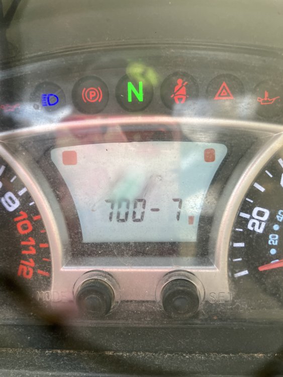

2022 sector 750 GAS powered: Codes E-113, E-108, E-123, E-132, E-650. What are these?
Less than 40 miles can barely start. Dealer is working with Hisun on a number of other issues on this UTV. Can not get clear info on the meaning of these E codes this is getting. Anybody have some clear info for me?

The codes are at the bottom of the ECU manual page 66. The ECU manual does have some T/S stuff in it. You could be missing a ground to the components listed below. Possibly inside a connector i.e. male to female connector not making contact.
https://netcult.ch/elmue/HUD ECU Hacker/Delphi MT05 & MC21 Manual.pdf
P0108 MAP Circuit High Voltage
P0113 IAT Circuit High Voltage or Open
P0123 TPS Circuit High Voltage
P0132 O2A Circuit High Voltage
P0650 MIL Circuit Malfunction

I was going for a ground concern; it was the E Infront of the codes that was throwing me off. Why didn't they just show a P instead.
It seemed to me it was a loose ground because it changed with the weather, literally every time it rained it had some other fault showing and different running concerns.
I have suggested checking the engine to frame ground to my dealer who has the vehicle now. He seems pretty sharp but is new to Hisun products.

Kinda weird it's showing all high voltages.
Anyone checked the voltages at the batt when it's running? I wonder if the regulator failed and it's getting an excessively high running voltage.
Not a charging problem. Has issues when trying to start, pops codes when it does not even stay running, It will display a code when it does run until I make a right turn at the top of my driveway and the code goes away. If I drive back down my driveway I might get a different code, and that code might just disappear before I get back to the top of the driveway. It gets even worse if it rains while it is parked. It has to be a poor connection someplace. Dealer still has it, have not talked to him for three weeks so I have no idea if he did any of the needed repairs yet. My wife totaled her car last week so I have different concerns at this time. If it ever does get fixed, I will be sure to post what the cause was. I do not have a lot of confidence at this time, as I mentioned in a previous post, I am going to look into the lemon law for this state.

Well, the dealer has had my 750 for seven weeks now for a number of issues that he has been putting off. Not a happy camper! However I was told that Hisun felt it was possibly an MCU problem and it was swapped out while it was in a no start condition. It  seemed to run OK, so the original was put back in and they had a no start condition once again. They then replaced the MCU and felt that there might be an internal intermittent connection to one of the connector pins that was the cause of the codes and running issues. I hope to get my 750 back very soon and if it passes MY smell test, I will call this issue fixed at that time.
