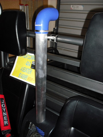

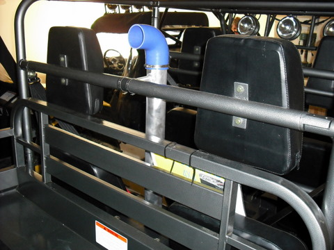

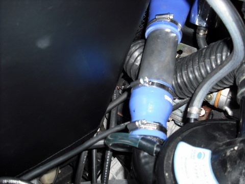

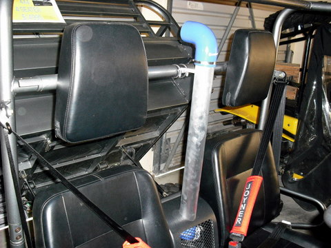

There is more than one way to tackle the heat & dust problem you may have with your Renegade. This is what I did on a Commando 4 seater. The Commandos have a normal intake like the Renegade so we simply ran good quality hose & stainless steel pipe from the intake box up and out into the open and topped it off with a 90 degree bend. An enclosure was going over the top so we faced it forward to ram air into the intake. A small pre-filter is recommended to go over the hose.
post-85-126868483517_thumb.jpgpost-85-126868479803_thumb.jpgpost-85-126868484602_thumb.jpgpost-85-126868485287_thumb.jpg
Cheers Mike
