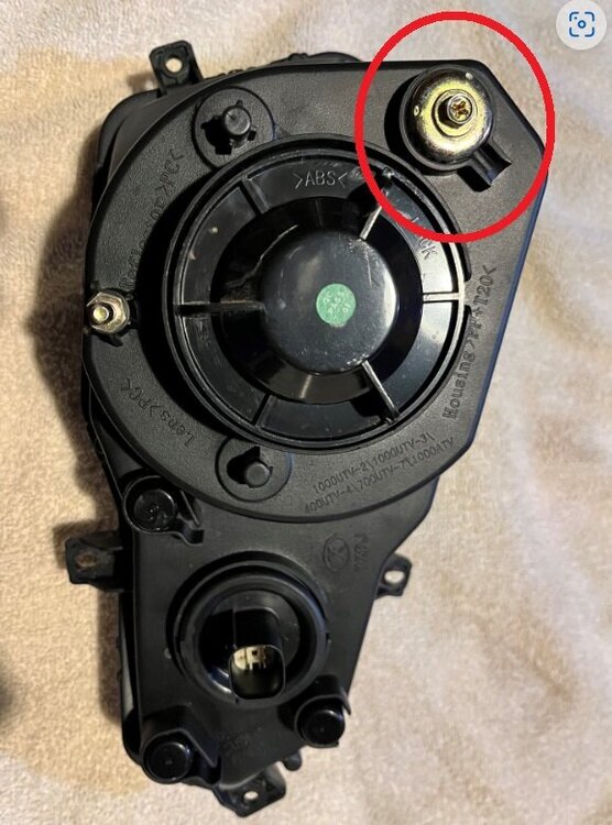

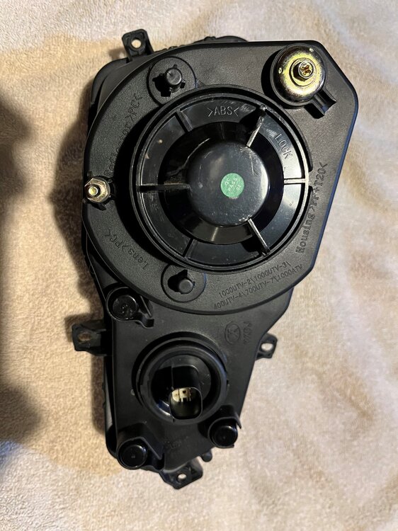

Well I called the dealer and he was going to call the UTV Rep. and ask about headlight alignment. I haven't heard anything yet so I removed the assembly to check it out. I didn't see any way to adjust the headlight so I will try putting shims on the top mounting screws which will tilt the assembly at the top, giving me the hight I need . I'm posting a pic of the headlight assembly. I don't see any adjusting screws. Not sure what's under the black plastic caps but it didn't appear to be adjustment screws.
Randy
Randy, Stop! no need to shim. The adjustment is that one phillips head screw you see in the picture at top right. Up and down adjuster screw.
They seem to miss the detailed set-up at the assembly. They just do not check things very well IMO.
Hope I saved you some work.
Garrick
Thanks Nods, That did it. I thought that might be a ground for a different application or something. I didn't see anything in the manual about it. Thanks again for saving me some work.
