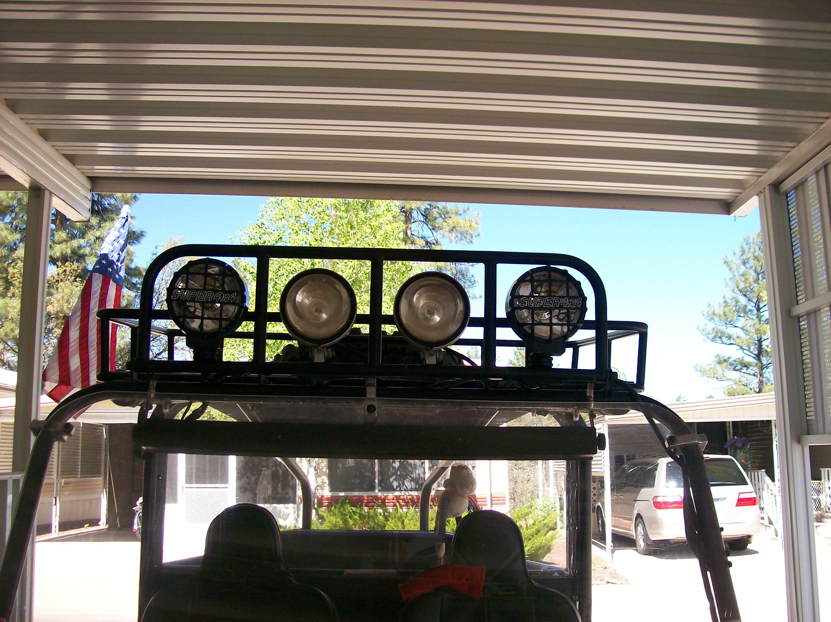

I'm sure somewhere on the forum is the answer to the question, what is the Trooper alternator output? I just replaced two of the lights on my light bar with 55w HID lights. According to Mr. Ohm they would normally draw about 4.6 amps each.
After the initial ballast start up they are drawing about 3.6 amps. The question is whether or not the alternator will support running all the lights.
I'm going to try them out on a short ride tonight. I'll let you know how they work out. If the battery implodes that will probably answer the question.

The light worked great on my short night ride. The only problem is the stock lights look really dim compared to the HIDs.
I'm looking forward to a better test on a upcoming night ride. I'm going to California for the Eastern Sierra ATV Jamboree where they should get a good workout.
At $106.00 for the pair I figured I couldn't go to far wrong. The color is great, 6000k, and having the ballast built in makes installation a snap. It was interesting to see the care Joyner took in providing good connectors. I put dielectric grease in the connectors and was good to go.
Gumball
I know the Renegade has a high output alternator to cope with 2 Head Lights 2 Fog lights and 7 Spotlights. that's 11 in total. I don't think the Trooper would have a less capable alternator so should be fine. They look really good, your have to buy two more now.
Cheers Mike.

That's a very good price on the HIDs, where did you get them? I put two on my T2 but mounted them on the front down tubes. I wired them with their with a switch. Had problems at first with only one light coming on, then I realized that you must have a relay switch in line. Now all is well. I also replace the two head light bulbs (H-3) two wires for high and low beam 35/35W with a Hella 100W bulb. I can not find a manufacture that makes a H-3 bulb with two element. anyway I am just using the high beam side of the switch. Thinking about taking off the overhead lights, they just don't seem to be doing much.

As to the use of a relay, I found so far that it's not necessary. HID lamps by their vary nature take a while to get up to full output. After the initial current surge they settle down. One of mine comes up a few seconds after the first one lights off.
With the lights mounted on the light bar you have the advantage of having them mounted higher than on the fenders. These lamps are so bright and the beam they throw is so focused they would be worthless as regular car lights.

Gumball, Since you are just replacing two of the overhead lights, you are going through the relay that is already in the system. It is located in the fuse box in front of the passenger compartment.
