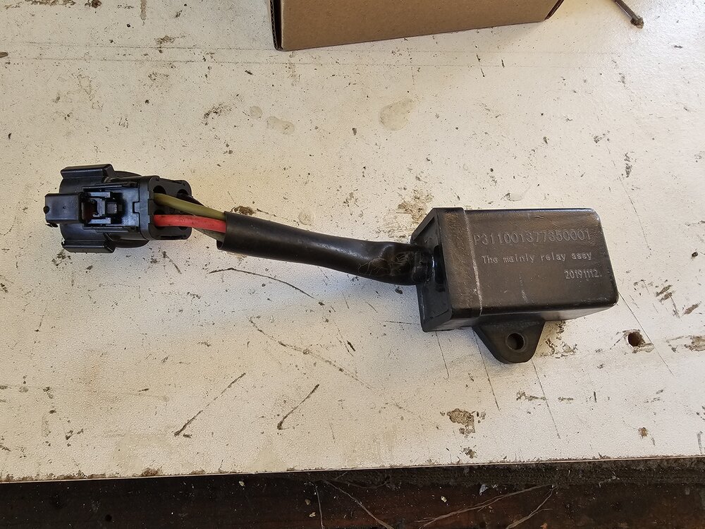

Just a quick update, I believe the problem is the main relay. This is not a serviceable part. It's not the small box with some fuses that some models have, it's one small relay plugged into a wiring harness. Weird thing, I happened to be walking by it, turned the key, and it magically worked! At least I was able to get it back home!
Relay sticking? Any corrosion visible? If it does it again give it a sharp tap with the bandle of a screwdriver and see if it resolves temporary.
Most relay failures I've seen are due to arcing on the contacts or corrosion from water getting inside. They're not well sealed.
  • Solution
Yes, I can understand that, and yes, I did tap the main relay quite a bit, it's quite different from normal relays... Honestly, I can get the cover off of a normal relay and visually inspect it... I'll share a pic of it, I ordered one off of Amazon, waited for it to fail again, replaced it, and no more trouble!
