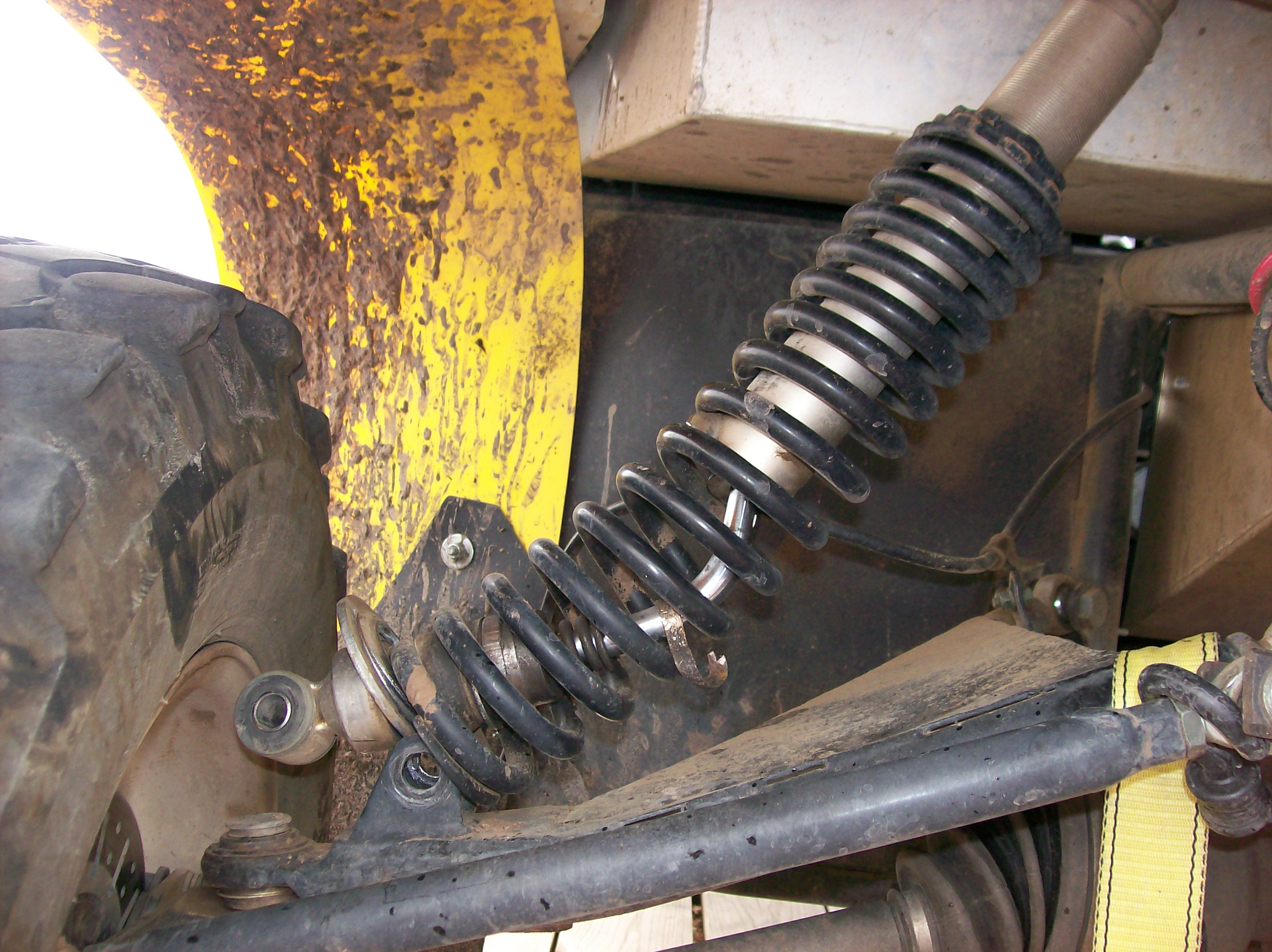

After yesterdays ride in some brutal rock I noticed something not quite right in the front end. After careful inspection and considerable deliberation I came to the conclusion it may be this shock. See attached picture.
I guess this means I will have to replace the shock. It's probably not covered under warranty.

That's twice I've seen that happen here on the forum, passenger sided both times. What were you doing, what speed, how much air time?
You didn't get any photos of the area / road you were on did you? My thinking is that the front end is over sprung and under dampened.

I agree Kinarfi. I been considering taking a little spring tension off of the front shocks. If that helps, then I will back off a little N2.

To answer some question as to how I managed to destroy my shock, here are some details.
I was riding in the White Mountains of AZ. We were doing a fact finding ride to show our AZ State Senator some areas that she could help us with. She was my passenger (fell in love with the trooper).Some of the trails we were on had considerable down fall and hadn't been ridden for some time. Some of the downed trees were 3+ feet in diameter. At times the rocks were football size and bigger. It was 4x4 time with locked rear end in these sections. The trail was steep and I needed to carry some speed. Needless to say I must have hit a rock very hard to bend the shock. The Trooper was still drivable. I noticed it was not quite right but we were on to a smooth surface right after the last rocky section.
The front shocks are at factory setting.

My friend at Buggy World in Santee CA set me up with some stock shocks so I should be back on the trail soon.

Thanks Gumball, when you get that spec sheet put together, Post it. I think Rocmoc may have a good idea about dropping the N2 out of the shocks, not sure if I have or not, or if I did and Lenny put it back in for me, but from what I've seen, it looks like the shocks top out after a compression and keep on topping to push the seal cap off and then you loose the guide and the shaft bends. I've been under the impression that mine's too stiff for quite a while and I have it adjusted for minimal preload, guess I go bleed the N2 off completely, forgot about that trick. That's one nice thing about my F-O-As, not pressure charge and if I do want some, they say it's ok to use air and start with about 5 pounds and work up, mine is smooth and I like it that way, I hit bump the jolt the front and are barely noticeable on the back, you know like old folks like. :D A little hyjacking here, sorry, but after breaking a fitting on one of my shocks pulling the camo'd trooper driven by Lewis when he lost the lower gears and got stuck in the water crossing, I had to rebuild it, all I did was replace the oil, Honda 5w fork oil, but since I had to do one, I did them both, easy, & I liked what I saw inside, although I'm no Pro.
