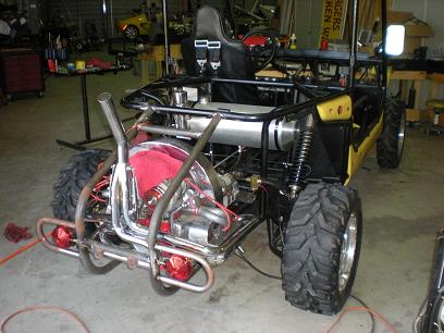

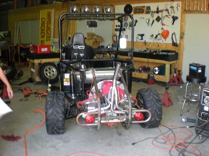

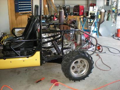

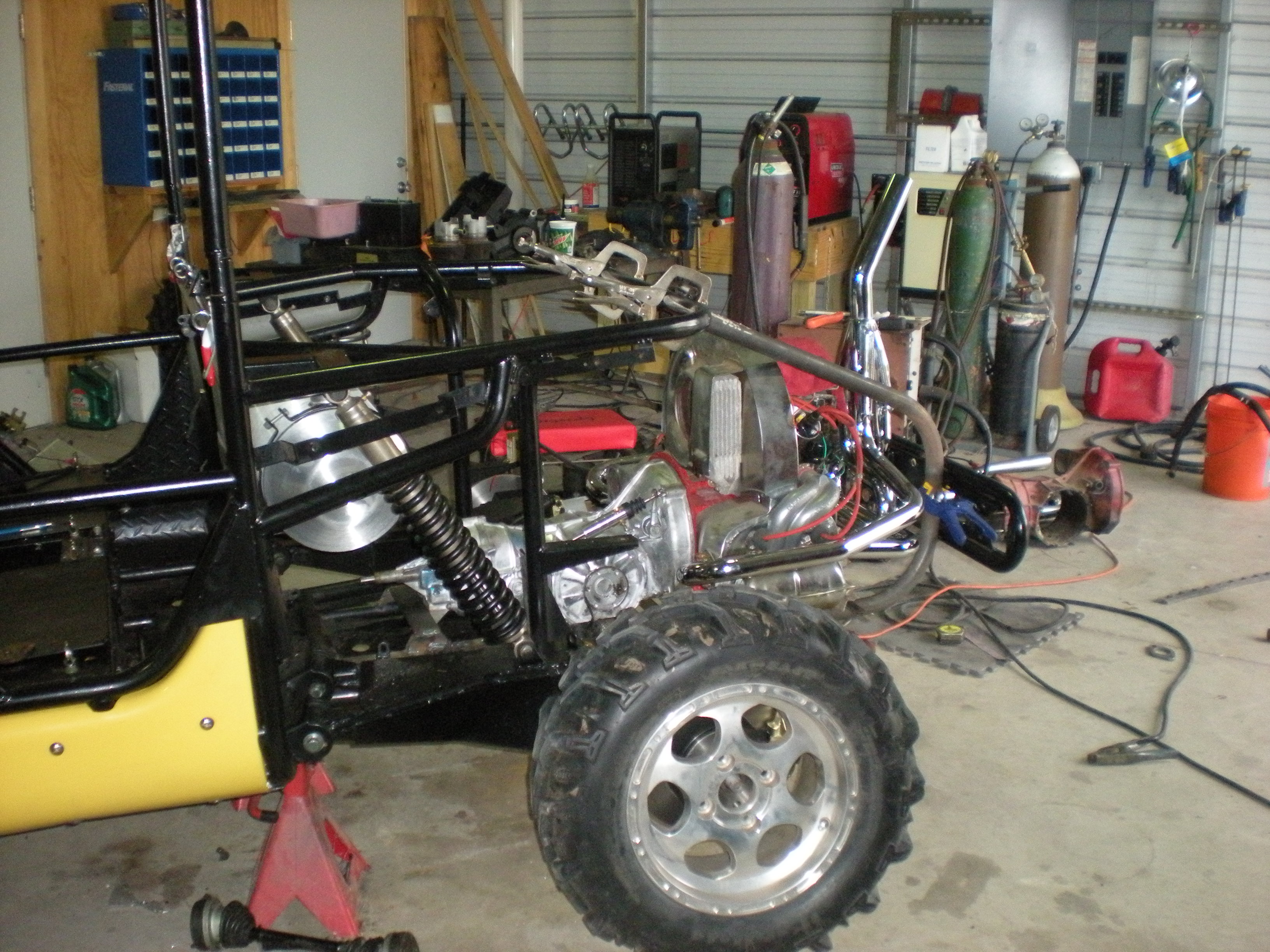

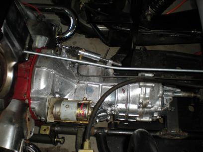

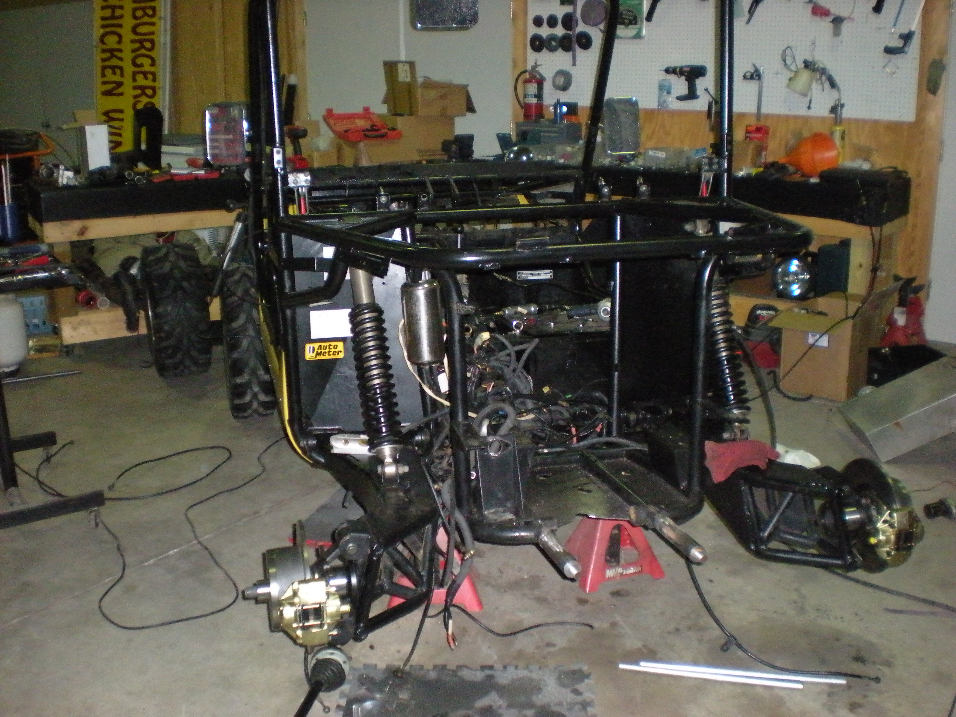

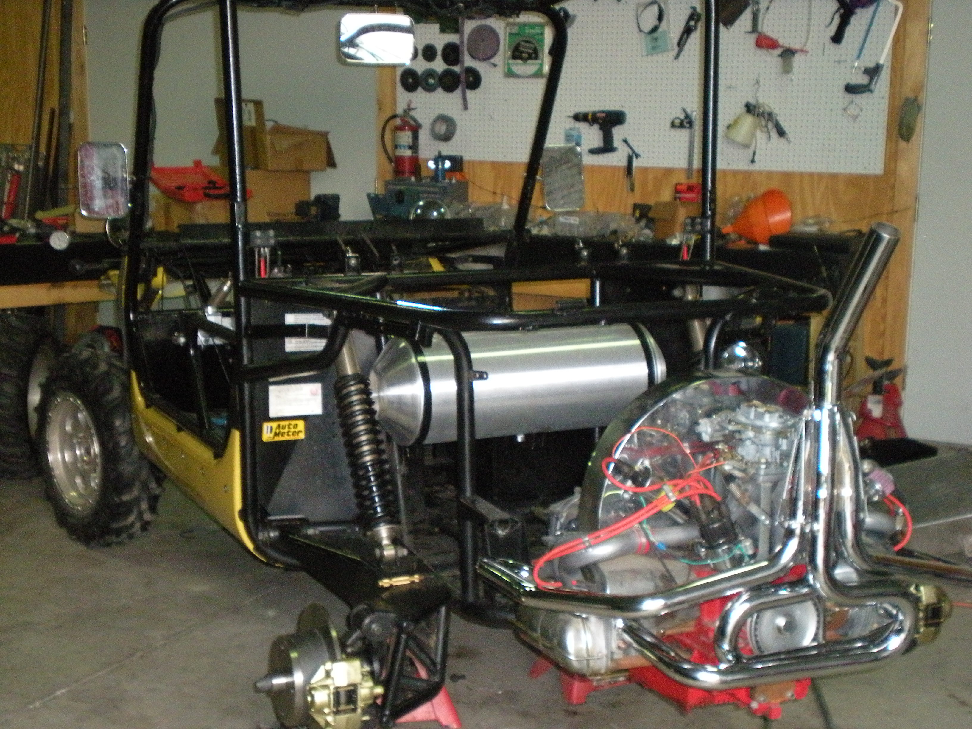

Here are some pictures of FRANKENJOYNER In the early stages. At this time I have completed the rear of the chassis with a bolt-on sub frame that in one of the pics is started. This looks real nice and adds what is needed to the origonal chassis so it doesn't look like an engine sticking out of the back of the origonal frame.
You can see the basic tranny /engine install and rear hub conversions to adapt to a VW bearing carrier and IRS axle stubs. Not much left to do before the maiden test than disassemble, powder coat the new parts and re-assemble. I did add a couple uprights to tie the tranny mount tubes to the chassis frame, though not in these pictures.

Looks good,definately opens up your options for other engines if you want.Keep us posted with the progress and more photos.Are you interested in selling the chery engine and trans?
