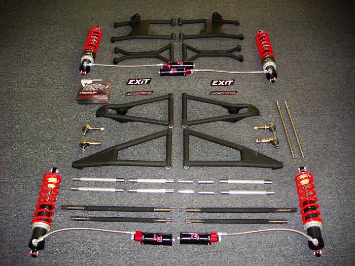

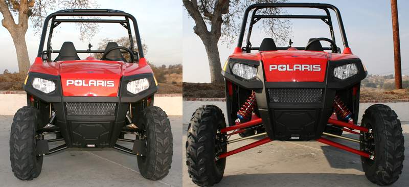

I want to custom fab or buy a long travel kit for my trooper. Has it been done? Could just any driveline shop make axles long enough? What else would I need besides longer axles and brake lines? I attached some pics of a rzr long travel kit to show what im talking about.
