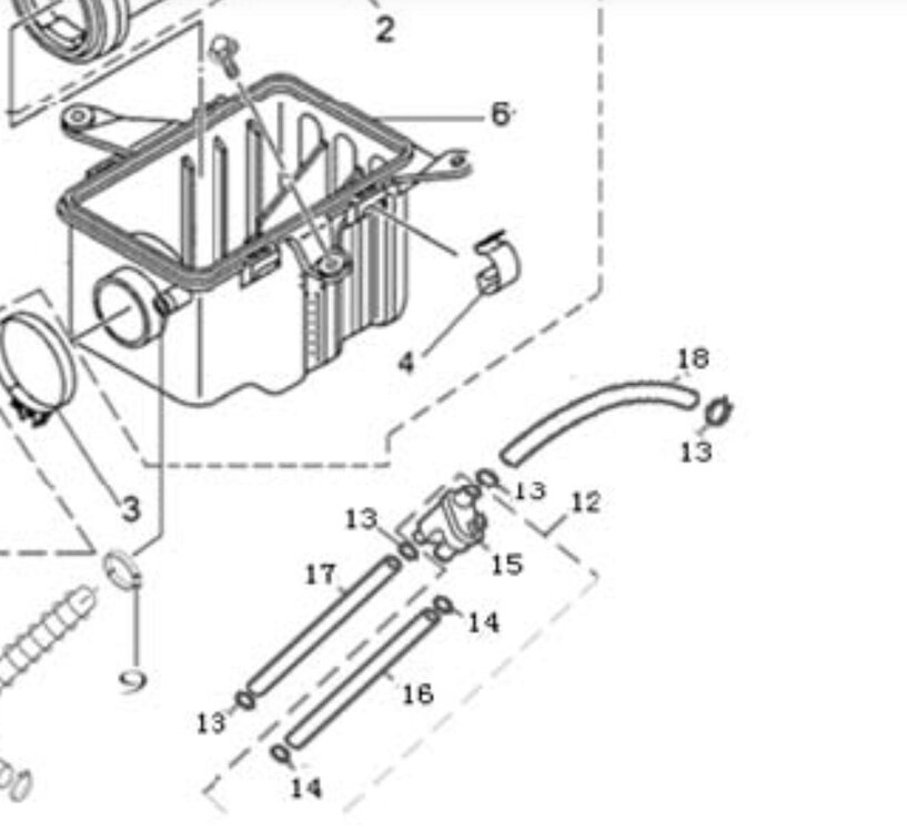

I'm not familar with the older carbed models, but pretty sure this is made by Hisun.
Looking at diagrams might it be pat of the EGR circuit? Tubing would be #18 in below diagram, hooking to an oil/fuel separator #15 below.
There also should be some sort of diaphragm based fuel pressure regulator on those too I believe.
You can go on alpha sports website and look at diagrams for the older Hisun 400 models and they should match.
Thanks for the info.  I checked Alpha Sports and could not find any information for a carburated Hisun 400
I cant remember which model i chose that diagram off of, any of the models labeled "older" with carbs should be similar. All of these things are essentially identical with scaled parts and different chassis/bodies. A lot, but not all, of the parts are directly interchangeable.
Pulling a carbed model diagram off another Hisun UTV all the plumbing and wiring should be the same to where you can at least see how its meant to be setup. The actual "yardsport" branded models are pretty rare I've only ever seen a few of them posted, but they're the same as the earlier UT400 pre-EFI.
