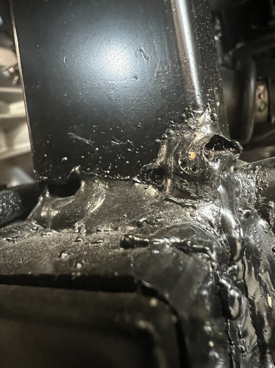

Hisun Vector 500 10 hour inspection
By SpaceGhost
They will be coming off.
