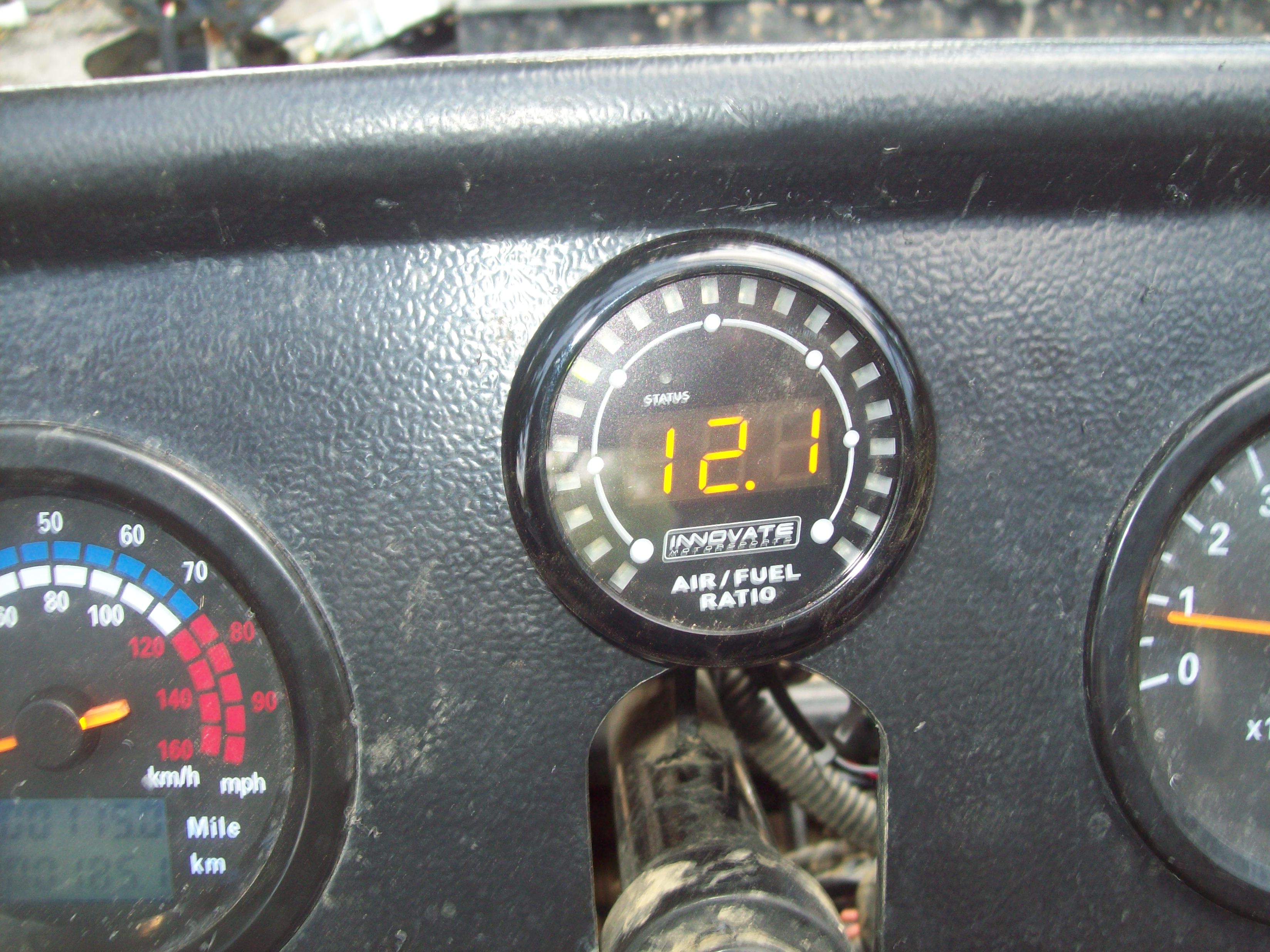

Getting ready for my cams install and air/fuel ratio gauge so I can ajust my fuel controller. What numbers should I be looking for 10.7 to 12.7 or what post-178-0-43496300-1310254986_thumb.jpg
Guest Lenny
Read your plugs. If you look in Google, You will find charts with pictures showing different plug conditions and what they mean. 10.7 may be a bit rich. I would shoot for maybe 11.5 when accelerating hard and about 12.5 when you back off a bit. If your just crusing it should be more 14 to 15 with 14.7 being a complete burn ratio. Best power will be around 11-12 area. Like i say watch your plugs. If you run too rich you stand a chance of burning your valves even though you might get a bit extra power at low end buy being extra rich.
