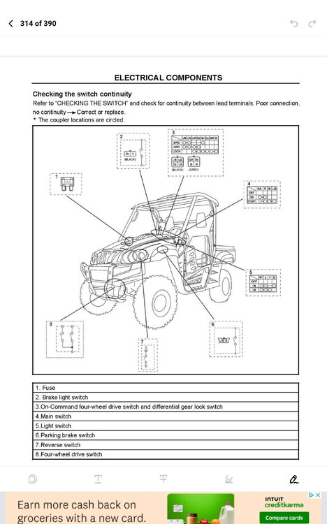

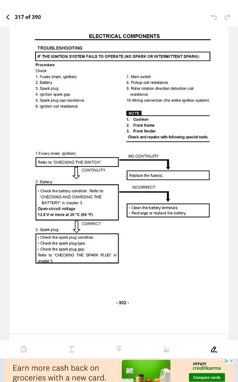

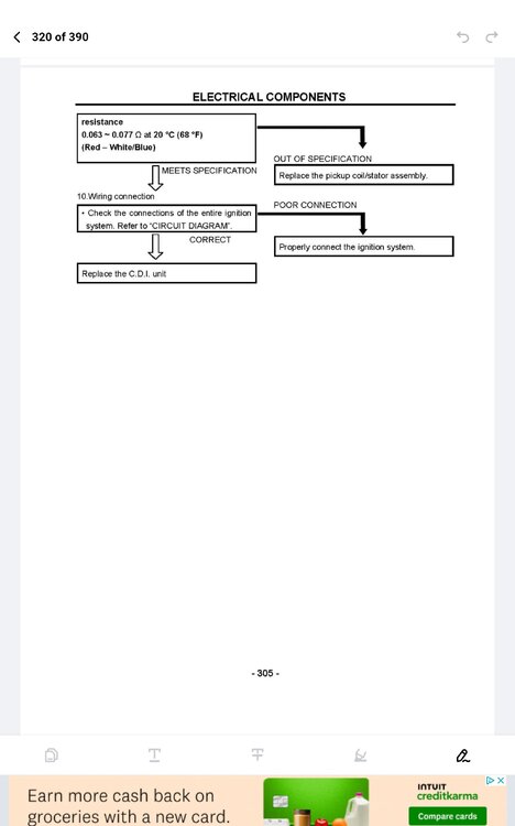

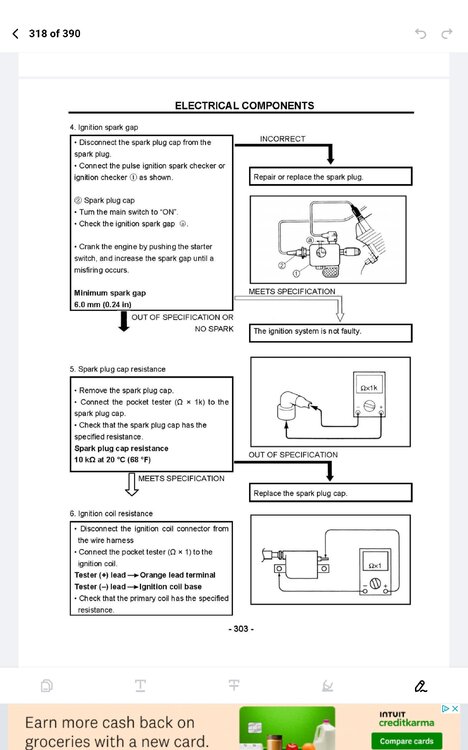

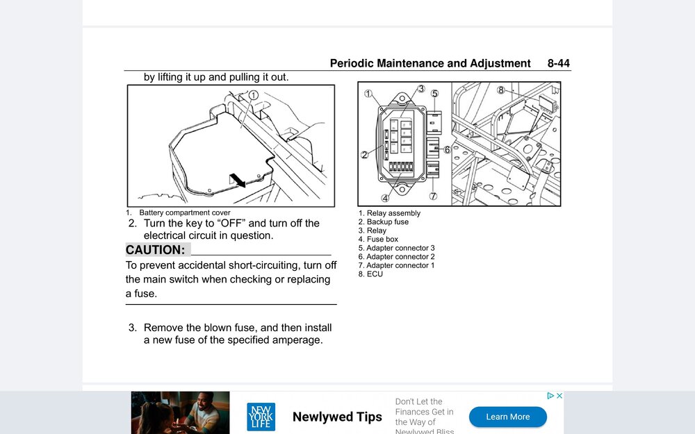

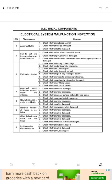

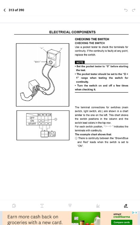

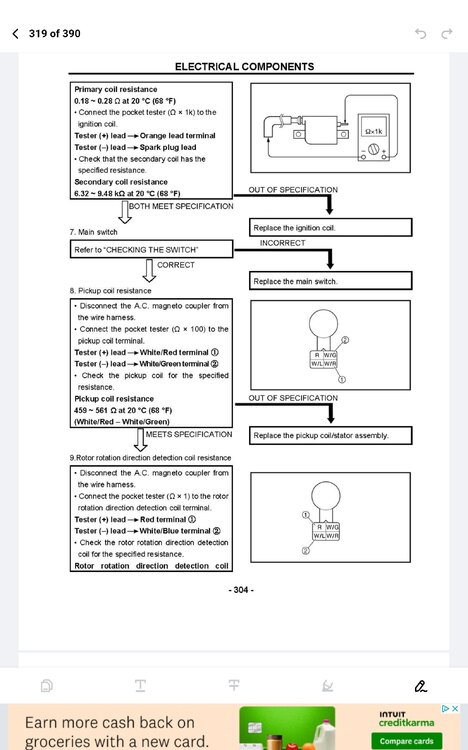

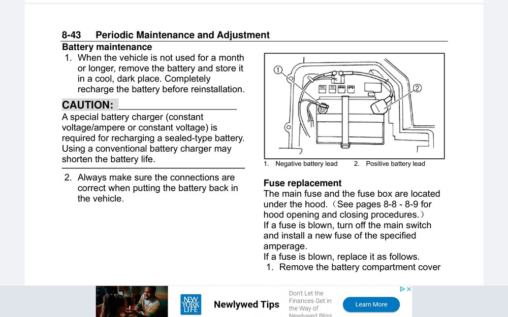

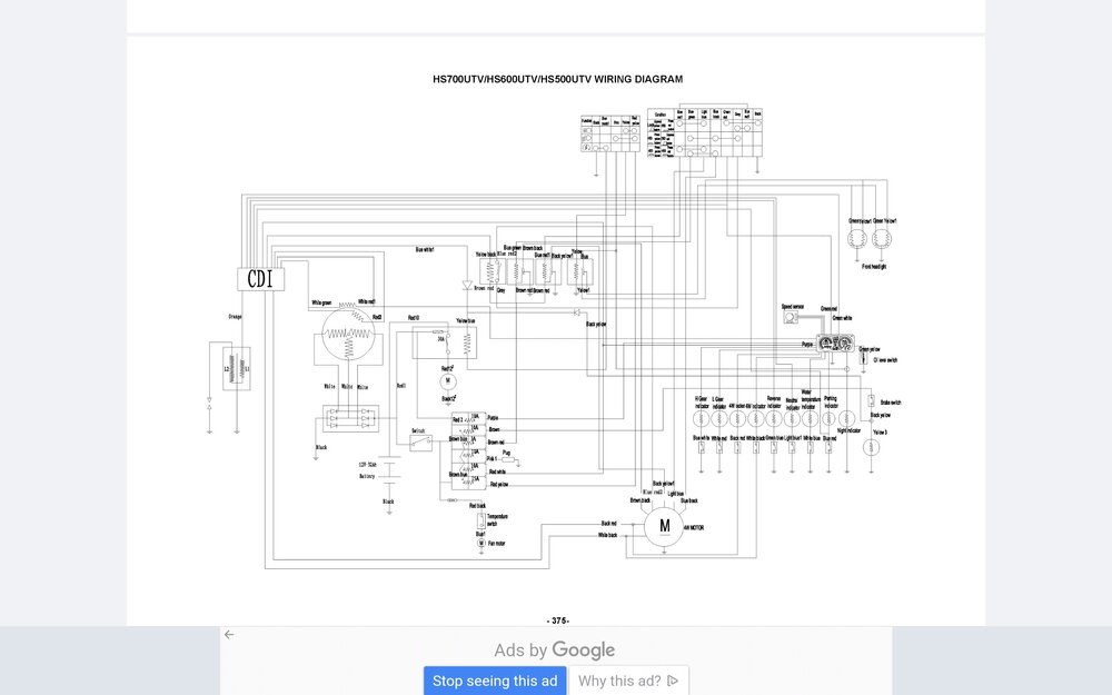

Could be something in the key switch shorting out and sending a kill signal. Could be a low oil level switch/sensor also. Could be bad coil. Could be bad fuse. In pages below main switch is the key switch. Q
I got these pic/pages from a service manual in the download section. Hope something here helps.

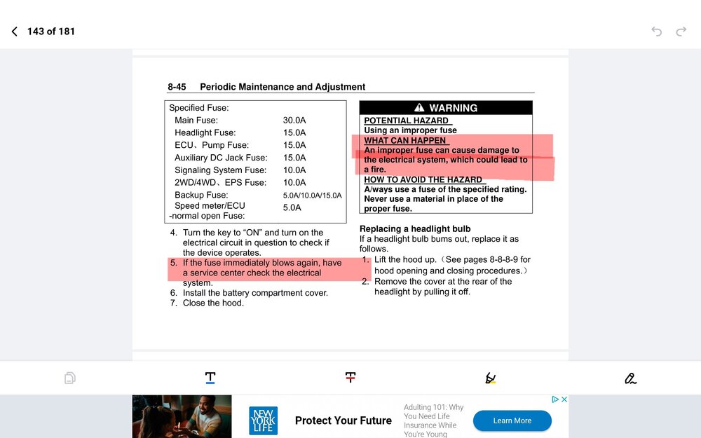

It was a fuse to the ecu put one in it blew it within 30 minutes it was a 15 amp fuse I put A 20 amp in it’s place no more problems so far. Thanks again for your help
Glad to hear you found PART of the problem. Reason I say part, is there is a reason that fuse blew.
If the original fuse was 15 amp. And it worked for 2ish years then blew to protect the circuit. There is a short causing the fuse to blow.
Hate to say it, but sounds like there is still something wrong. Something is causing the fuse to blow. If you don't find what that is. It may cost you a lot more in the future.
You have narrowed it down. Now just trace down the wires in that circuit to make sure there are no chafed wires. I'd remove any tape or wire lume and inspect the wires themselves. Repair any bad spots. And put the original size fuse amperage back.
