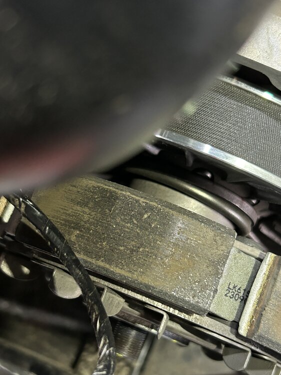

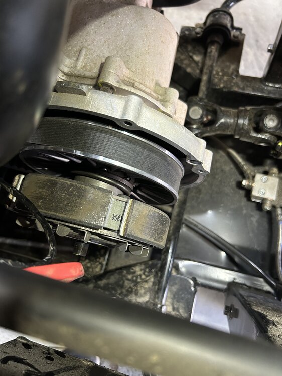

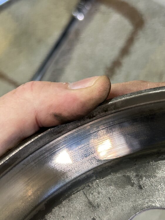

My SLR BISON 200U SPUDDERS and or chuggs just when Taking off from stopped. It's fuel injected, warmed up enough.  Doesn't do it all the time. Anyone else having this problem  ?  Any ideas ???
I have a bighorn 400 that had a similar problem. On pavement it was horrible, but in the dirt not so noticeable. If it’s like mine you’ve got glazing of the clutch shoes and bell. Toook some sand paper and removed the glaze and now she’s as smooth as silk
