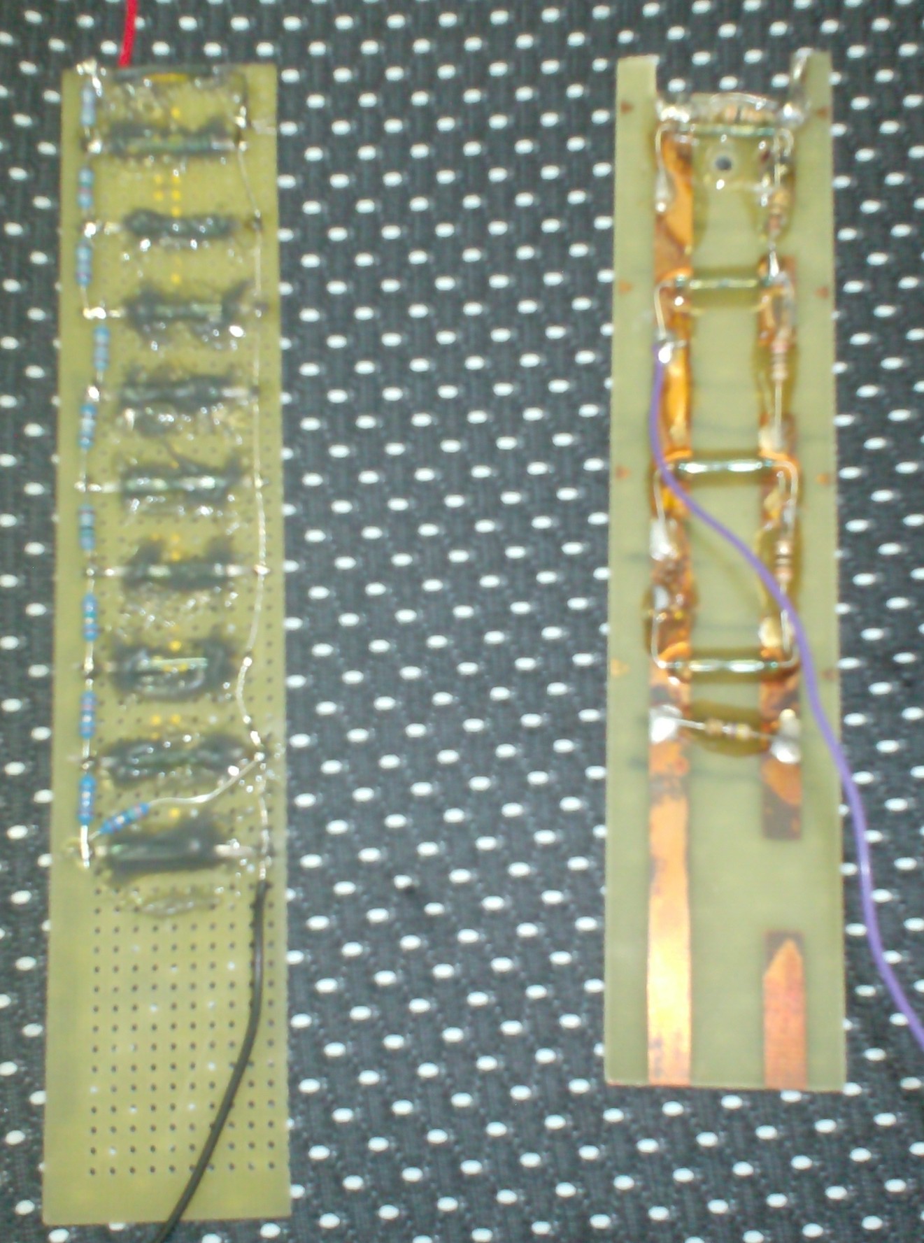

2523214430104282158mXeElu_th.jpgHere's the components in the sender, the switches are reed switches activated by a magnetic float. I've repaired a few of them for myself and other members. Replaced mine with a capacitive sender unit that I built and need to pull out and see why it's not working, in the mean time, I just make sure it's full at the beginning of each outing.
My capacitive gauge quit working so I went back to doing the way Joyner did sort of, instead of 4 reed switches, I used 10, now when the tank is full, the needle is on the white line, then 7/8, then 3/4 in the middle of the upper blue, then 5/8, then 1/2 on the middle white line, the 3/8, then 1/4 in the middle of the lower blue, then 1/8, the empty on the while line, the 1/2R in the middle of the red, then 0 on the bottom white line. The picture shows the old and the new.
