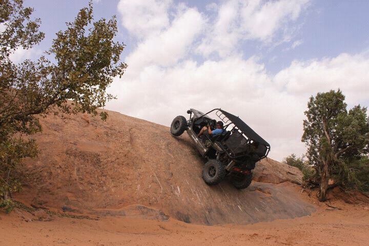

So, after repairing the CV I met Jeff & Linda at Poison Spyder. I popped my CV out in the sand but with Jeff's help was able to get it back in quickly. I did several steep walls with ease while large Jeeps stood by and watched. One wall a Jeep attempted and backed away, one of the other walls a fully locked Jeep rolled over on trying to attemp (that is the attached picture). Neither of those were the steepest wall I climbed. The steepest wall I actually had the front wheels in the air as I crested the top. That one scared me a bit. Jeffs Trooper ran solid the whole trail; however, his body did have a few spyder bites afterwards. His suffered from a little less ground clearance, but he was able to power through everything.
