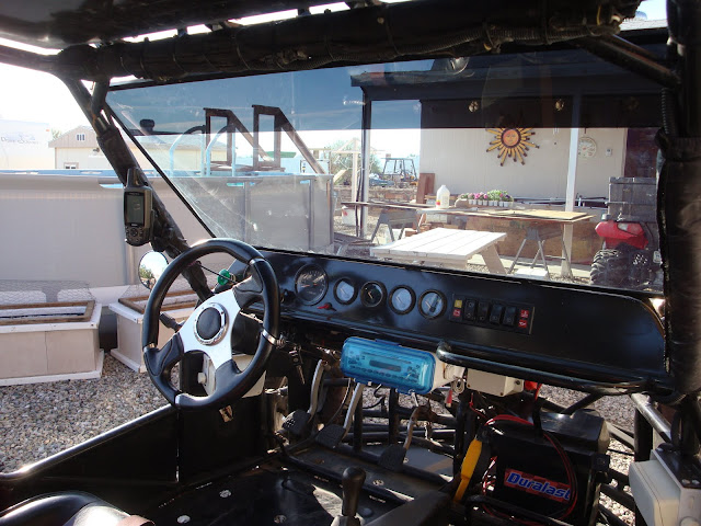

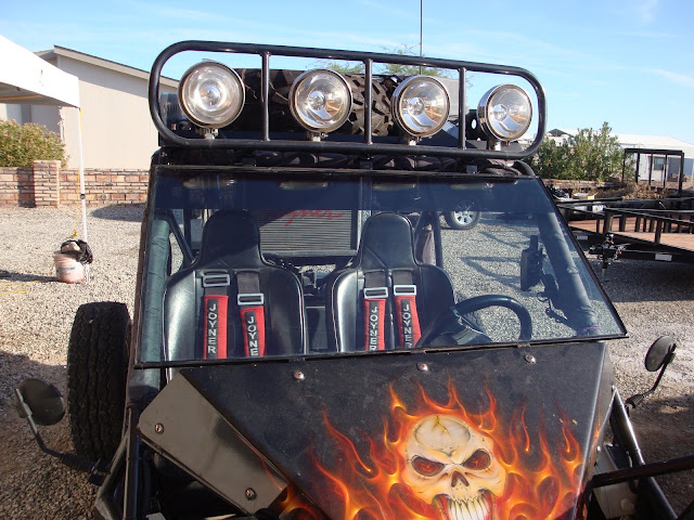

Kinarfi - I can remove my glass windshield within a couple of minutes because I used quick disconnects that Lenny sells with his windshields. 3 on each side. I used automotive safety glass mounted inside of 1/4 aluminum with square bars of aluminum welded at the top and bottom below the glass to give it support from flexing at all. Only thing I would have done different is not covered the whole front of the buggy. I have a T-4 so I don't get as much of the dust getting pulled through but I know a lot of the T-2 guys have said they had to put holes in the bottom to allow air flow. You could alter the shape of the windshield and allow for flow through the passenger side of the vehicle. I posted pictures on the gallery. Believe there are a few of them along with photos of the disconnect knobs. Also, windshield is not that heavy so no problems there.

Hey nocturnalsixer.........I held the polycarbonate in with nuts and bolts. I laid one sided sticky foam strips on the angle iron frame, laid the polycarbonate in, and attached flat bar around the edges with small nuts and bolts. They actually went through the polycarbonate.
With the glass I took the frame to a glass company in Parker, AZ and he cut the glass to fit and glued it in with windshield urethane. He didn't want to drill holes in the glass and said the urethane will hold the glass in just fine. Just had it done and haven't driven it yet but I'll let you know. Might take a ride today before it gets too hot. We're still 105 degrees in the daytime here.
