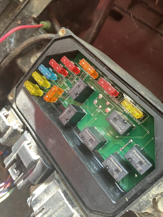

hello grizz again I keep blowing this fuse left side on bottom it’s a 15 amp I have checked all the wires can’t find anything bare or broken it is a 2021 axis 700 I put a 20 amp in so I could pull out of shop to take pictures. Does anyone have any suggestions. Thanks.IMG_1240.thumb.jpeg.32de95ab96c0d8bce67cb63e601cd685.jpegIMG_1240.thumb.jpeg.32de95ab96c0d8bce67cb63e601cd685.jpeg
Is this the same fuse going to ECU and fuel pump?
If you have checked and found nothing bare or touching. It could be a fuel pump going bad or a bad ground. Causing the pump to pull more amps to try and make the circuit. I don't know the steps to test. But YouTube or a Google search should show how to test amp draw on a circuit.
Best of luck
