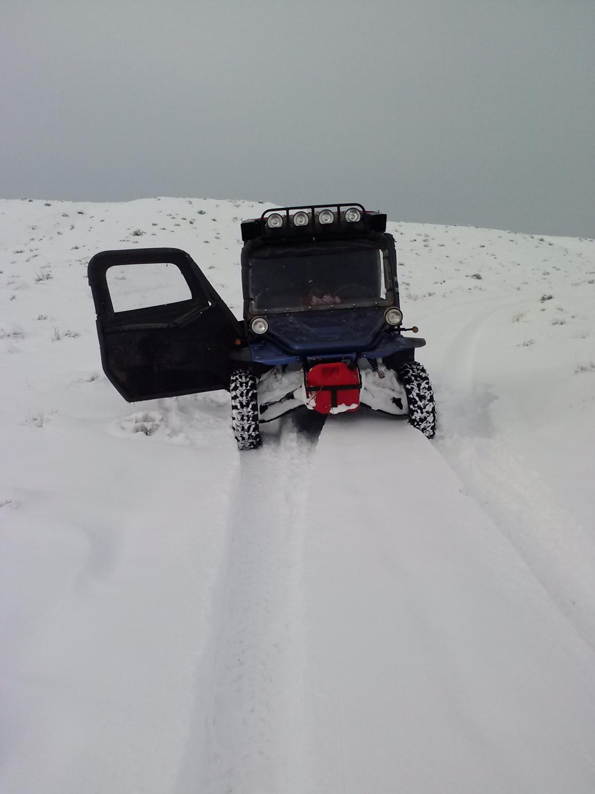

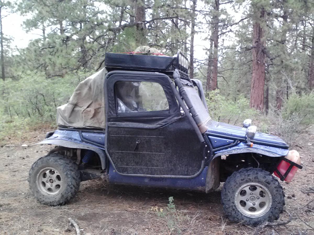

I have about 17 inchs of ground clearence with my shock set up. I have been in as much as 24 inches of snow so far this year and the T2 just keeps goin. I have a full cab and windshield which is nice due to the -0 weather I am hunting in. The only issue i have is I have to carry a squee gee to clean off the wind shield as the snow goes over the top of the T2 when it is that deep. Having the turbo is nice as well as I dont have to shift as much. When the engine starts to pull down I just give more gas, when the turbo spools up the T2 comes alive and plows through. I have got it buried in deep drifts which I had to take a couple runs at to get through. I carry a 6 gallon gas can in a rack on the front because driving in snow like that all day eats the fuel.
I have owned a Rhino and a Prowler. The Rhino wasn't even close to what I needed. The Prowler was better but even after a lift and pumping up the motor it couldn't come close to going where the T2 can go. I will admit I had to work out some issues with my T2 also. I put knew rear diff, new shocks, built a sterring kit I can grease, new ball joints, new intake housing which contains two air filters I use in my Ford Power Stroke, raised the shock mounts two inches and changed the shock angle which gives me 12 inchs wheel travel and 17 inchs ride height but also allows me to run the springs a bit soft which keeps the tires on the ground more. The next things will be a heater like Lenny has and perhaps a self parking wind shield wiper. I
