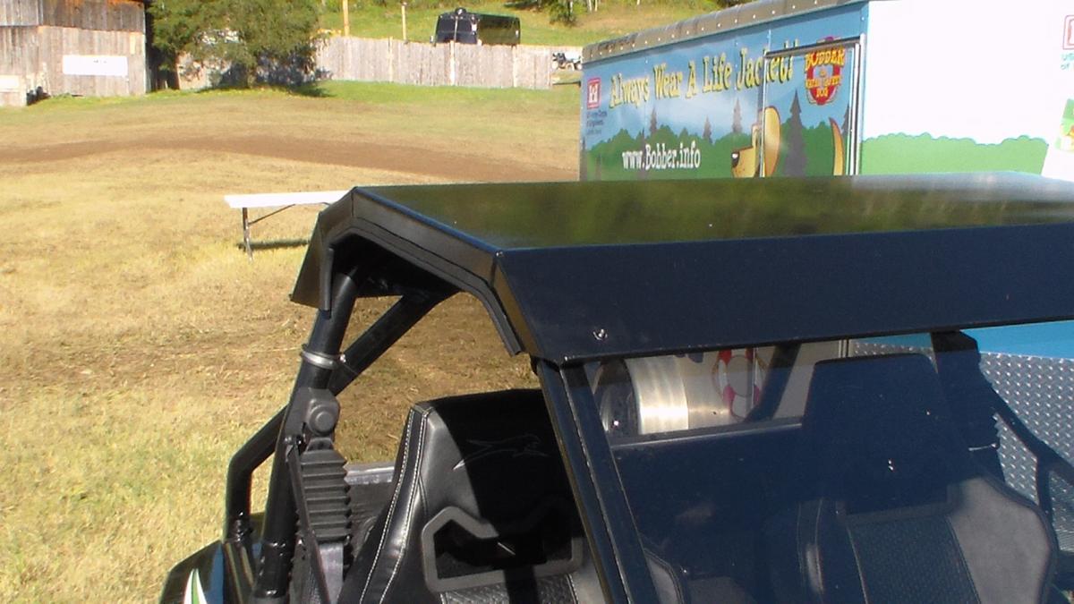

You asked for it! Too utility looking, Doesn't flow with the design of the Wildcat. If you are looking at going into the mass aftermarket, this will hurt you. Someone will build one that looks more like it was designed by Arctic Cat. Just my opinion.
