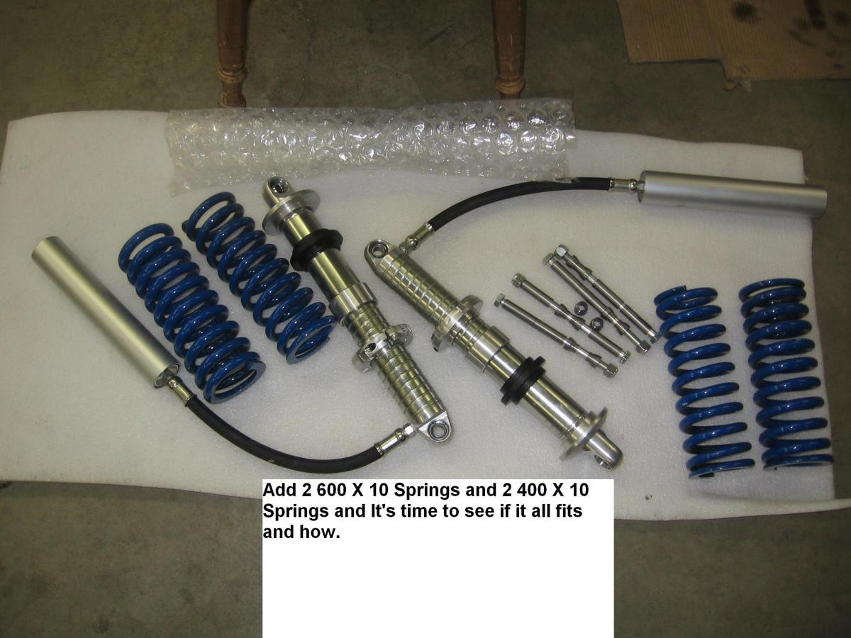

Pretty sure but not positive about these numbers for the fronts, less sure about the rears, if you are seriously considering FOAs, I'll check harder to get you the right numbers and more info about what I have.
Qty. Item Name Unit Total
Reservoir Shocks 2.5 FRONT SHOCKS
size - FOA-06
Compression Valve - Light/Medium
Rebound Valve - Light/Med
Mount width - 1.5"
$150.00 $150.00
Reservoir Shocks 2.5 REAR SHOCKS
size - FOA-08 ?????? maybe 10 inch
Compression Valve - Medium
Rebound Valve - Medium
Mount width - 1.5"
$155.00 $155.00
2.5" Springs FRONT SPRING
size - 2.5x14x200
color - Black
$49.00 $49.00
2.5" Springs 1 OF 2 REAR SPRING edited corrected
size - 2.5x10x400
color - Black
$49.00 $49.00
2.5" Springs 2 OF 2 REAR SPRING edited corrected
size - 2.5x10x600
color - Black
$49.00 $49.00
Dual Rate Spring Hardware REAR SPRING SEPARATOR
size - 2.5 shock
collar/crossover -
$25.00 $25.00
Sub-Total: $477.00

During this bad weather, (winter), I just reworked the front shocks to have more rebound dampening and haven't had a chance to try them, but I'm sure they are as good as any other shock, way better than stock, and you can rebuild them. The rears were doing quite well, but the front had too little rebound dampening and I have just fixed that, I hope, but need to test it.
