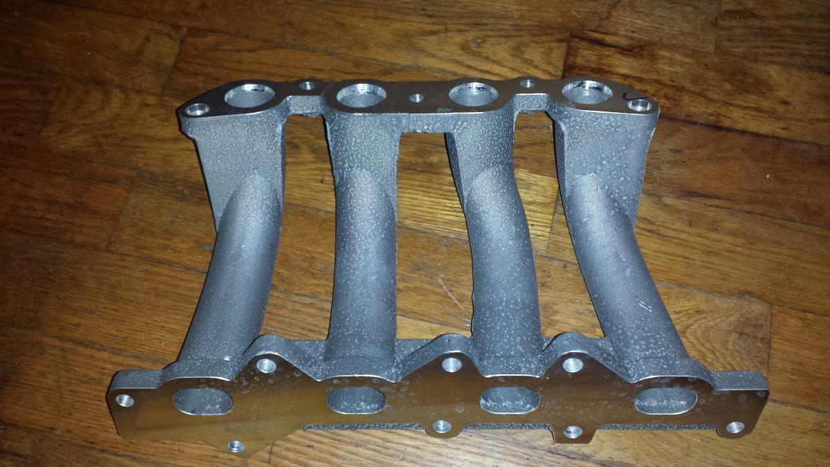

2scoops, That intake is what all sqr472 engine uses but the trooper. Yes I think it will be better longer tubes and it will pull the air down instead of pulling it up and your throttle body will be out of the mud. I'll let you know when I get it hook up. .

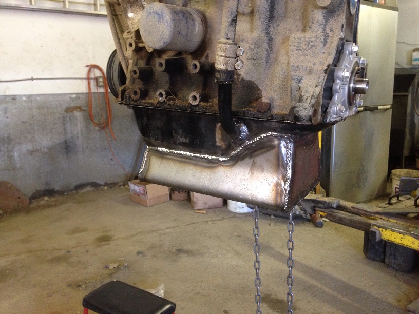

Just a couple of pics. The turbo header I had to modify slightly because the turbo would have to be mounted backwards from clearance issues. Just a slight cut and weld to angle the turbo down and all is good. The other pic is my custom oil pan. 7 L capacity. Thought the engine oil was running too hot, but turned out to be oil gauge problem when hot. Factory gauge and sender is crap. I prefer this driveline setup compared to a belt drive any day, but to each his own. I would like to see an actual auto trans with a hi low range would be the ultimate. I have a 75 blazer 4x4 automatic great for the mud.post-1877-0-98137800-1400277987_thumb.jpgpost-1877-0-26038000-1400278315_thumb.jpg

I like the intake a lot. So it was completely plug & play? Does it stick above the bed? Its hard to tell from the picture. Can you post a picture of where the throttle body comes through the front cab?

2scoops, Yes it was completely plug & play. I will put some more pictures up when I get home. And I do believe the bed will close right now it's hitting my oil cooler I will have to move it. If you decide you what one I can have it ship to your front door.
