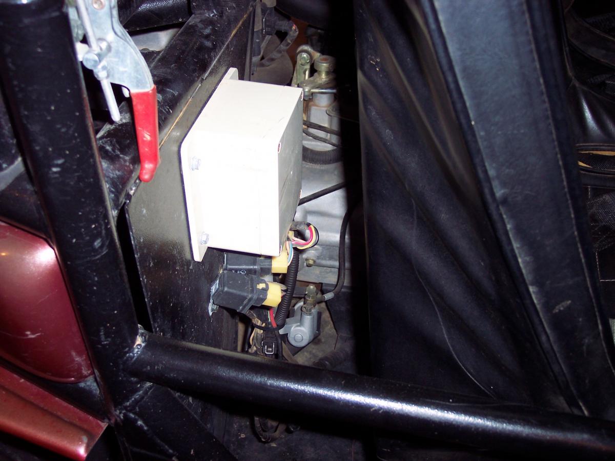

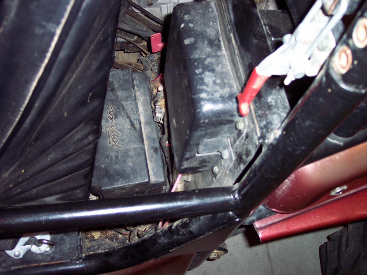

There is a black box behind the drivers seat, but it does not contain fuses. There is a sealed (white) box behind the passenger seat? When you refer to fuses under the dash r/f side, do you mean the passenger side? If so,
how do you get to it? There is a cover panel, however it does not have blind nuts on the inside and the nuts turn with the bolt.
My trooper is 09 behind the d/s i black metal black box the protects the ecm nxt to that there is a black plastic box which holds fuses even if the fuses are good u might wanna in bolt it and look at the back side for corrosion and burnt wires I think there are relays there to. On mine under the right side dash I have a black plastic box with fuses and relays I would check them as well. Does your hazard lights work normally

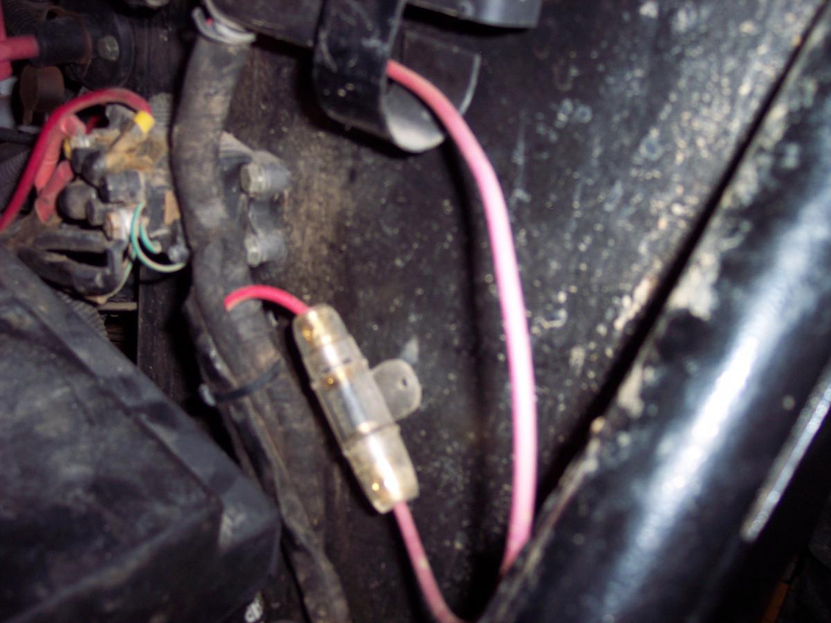

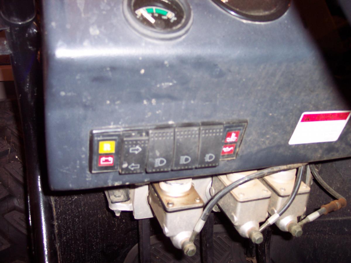

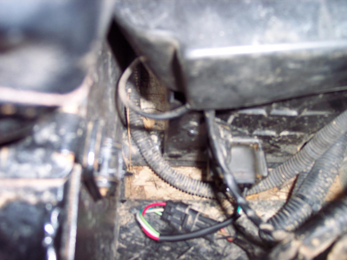

Looks like they made changes between the 08 and 09 models. I attached a couple of pictures for you to look at. I have to be out of town until Monday, so will have to put this on the back burner until then.
Ya that's a little different than mine have u looked at the terminal for the turn signals them self inside the light housing?
Found it. On the 2008 there is a mount on the battery box (next to the tranny tunnel) that the turn signal blinker is mounted to. When I pulled the part number, it looks like they used the same blinker as the 650 sand viper sand buggy.
Found the part on E-Bay for $10.00. Thank you for your help.
Can you post a photo of the blinker and the part number? My Trooper has numerous modifications by the previous owner(s) so I always struggle to find things where they should be. Your fuse box behind the passenger seat is quite different from mine. Thanks.
I have attached a couple of pictures. The part is located down at the bottom of the battery box and hard to get a picture of, but did my best. I was able to include a picture of the part itself. There are two metal brackets welded to the side of the battery box. A rubber boot slips over the two brackets and the blinker fits securely into the rubber boot. The part came from Borossi-Joyner, part # JSG142 and the price was $9.99.
