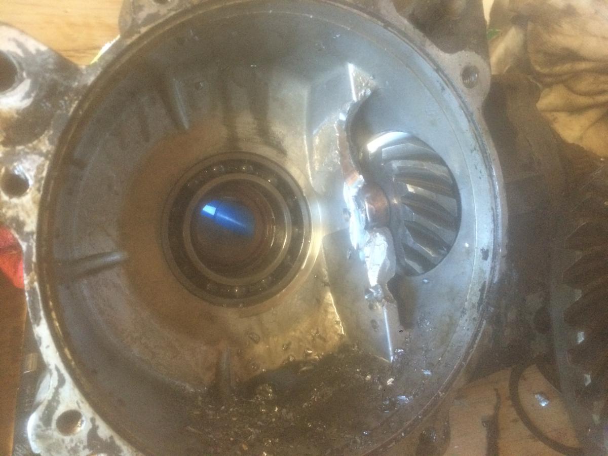

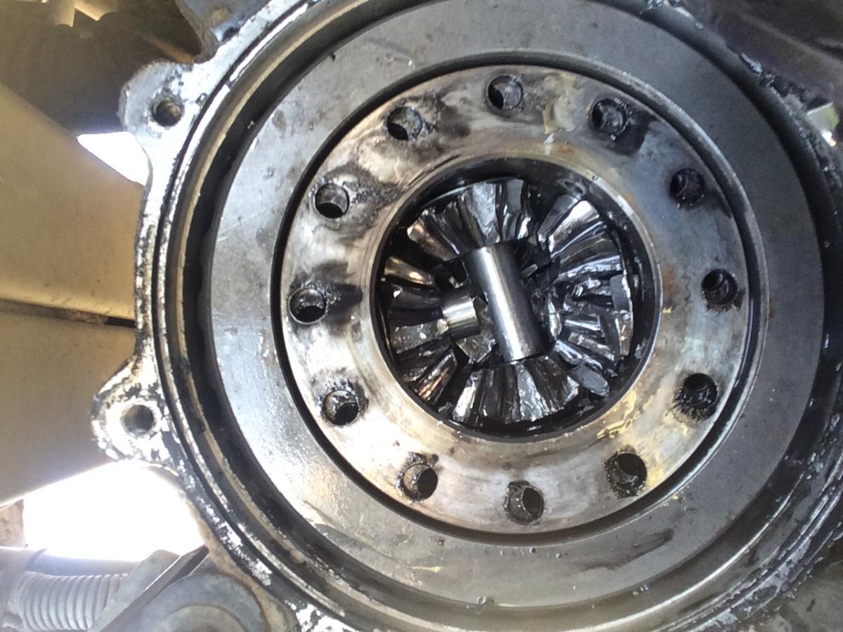

any idea of how the damage around the pinion gear happened? when mine did that kind of damage, the shaft for the spider gears had slid out a ways because the set screw that holds it in had backed out.
I used to have a bunch of photos of how to fix that problem and other stuff too. but I have no idea where I stored them.
