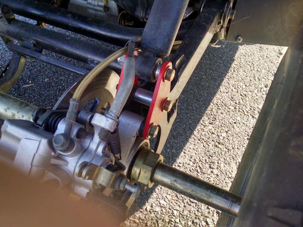

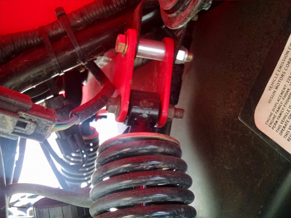

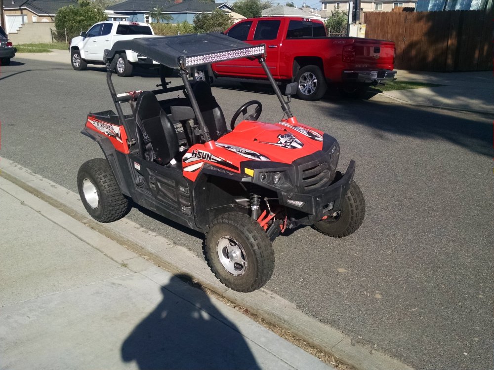

Hey there, new member here, just looking for information and tips. I just purchased a Hisun strike 250 for my young son. We have taken it to elsinore mx park here in so cal and he had a blast. I know I am going to get a lot of feedback regarding this, but I have to tell you, for the money, and his age, I can't complain. It always starts, is a blast to ride, and yes, I can fit in it at 6.1 and 195lbs. Have we had any issues? sure, but about the same about as any other vehicle, so I can't really complain. We couldnt find any aftermarket parts for it, so we engineered our own 2 inch lift kit for it, and it worked great. We have mounted additional lights on it as well. Some of the things we did notice are that the shift linkage seemed to be rubbing the exhaust pipe, and so I modified the shift linkage, and now that problem is gone. I also noticed that the factory plastic is very brittle, meaning it will crack if not handled properly. The quality of the OEM nuts and bolts are very poor, they seem to strip out very easy. So, we are replacing what ever bolt we remove, with a higher quality version. The battery is not easy to access, and in a pinch, that could be a problem, as tools are required to get to the battery. If you were to need a jump out in the boonies, you might be stuck. Also, the factory 4 point harness is hard to adjust, so we might have to replace them with aftermarket versions. Aside from that, he has not really had any problems with it. Granted it is not a larger 500 or 900cc UTV, so the load and demands on it are less. I do wish it had more power, but since he's only 9, I am good for now lol. It never quit on us, ran great in 106 degree heat, and handled the muddy track with ease. Another plus, it fits in the back of my truck bed with the tailgate up lol. Just my 2 cents.

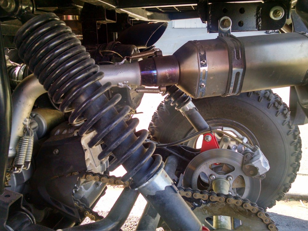

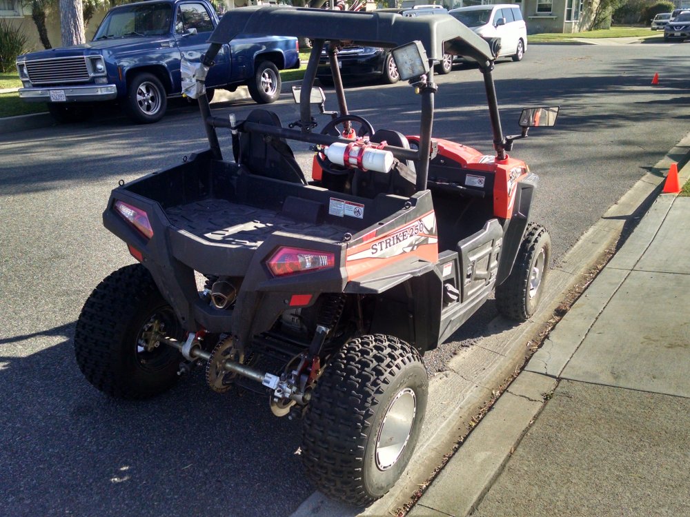

Here are some new pics of our test Hisun 250. with the 2" lift kit and our exhaust kit installed. Our Hisun hauls butt. It sounds great and seems to run just fine. I know there are haters out there, and that's fine. I have taken this down to the frame and down to every nut and bolt to research everything about this unit. I know all the good and bad things about this unit, probably more so than most dealers as I have done so much R&D on it. I have had the engine out of it a few times, and have gotten it down to just a couple of hours now. I know all of the parts that are compatible with Japanese UTV/ATV units. I have replaced many parts with more reliable parts, but I have to tell you, for a chinese UTV, this thing has not really let us down. We have tested it in many of the off road parks here in Southern California including Pismo Beach, Dumont Dunes, Glamis and more. I understand the suspension fundamentals as well as the limitations. I have done extensive research on the rear suspension to look at independent rear IRS compared to the OEM solid rear axle.  If you have any questions, please feel free to ask. With the right parts installed, this unit has a lot of potential to unleash. I have ridden this unit with myself, weighing in at 200 lbs, and another adult at the same weight and it just doesn't die.
We will be selling the lift kit and exhaust system soon, as soon as we get our website up and running and place things in the correct place on this forum.

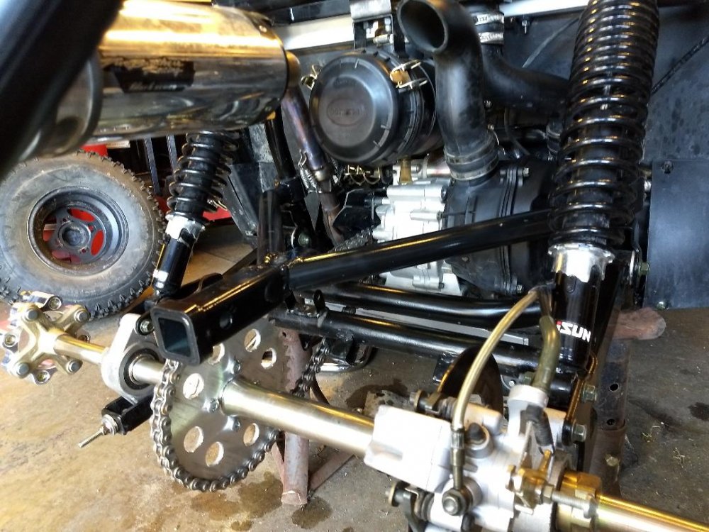

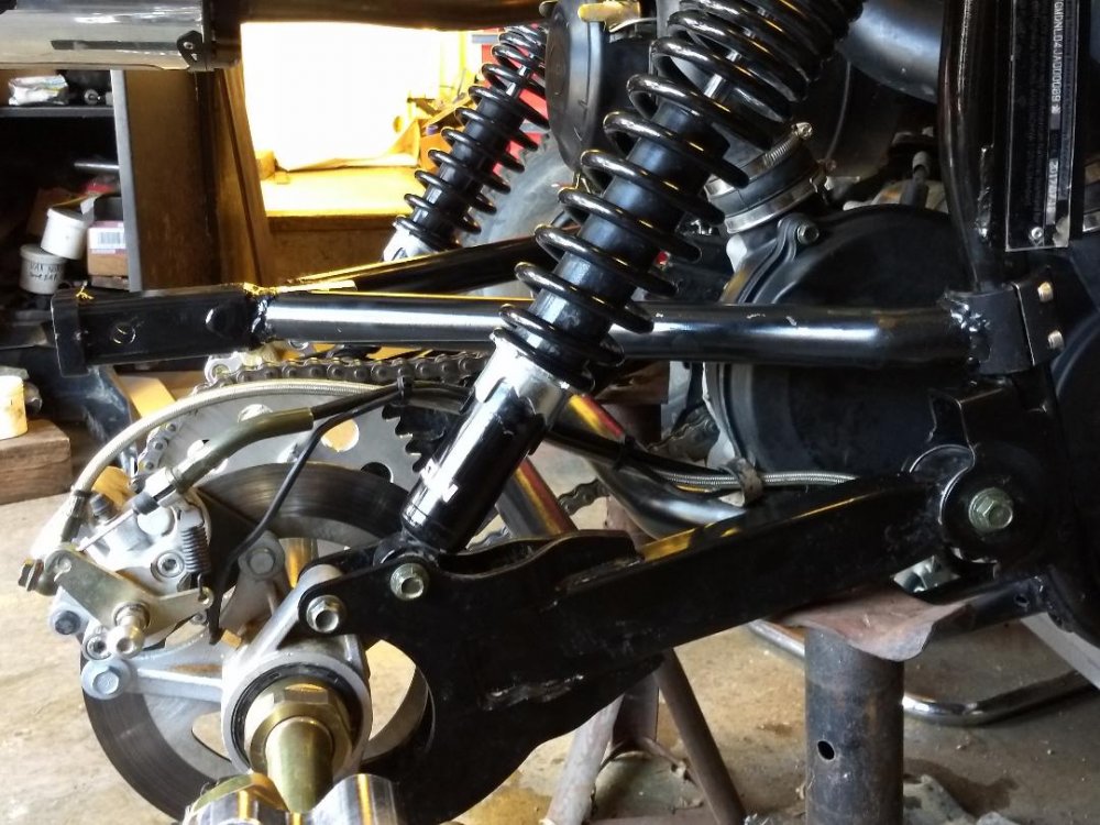

Hello there, just a note to those owning these fun machines. Remember to remove and lube the front A arm bushings. They are plastic from the factory and are pretty dry if any lube at all. To make them last, I would take them out and lube them up well to make them last and work well. I am trying to source some aftermarket bushings, and think I have found a source, but working out the details, so in the mean time, R&R those plastic things sooner than later, or you'll regret it.
Another spot to check out is the OEM chain, it is not the best quality. I understand during manufacturing you make thousands of these things. To meet certain price points you have to use a quality that meets your requirements, but is not always the best due to price. I would recommend replacing it with a nice O ring chain. A good quality chain will make your sprockets last longer as well.

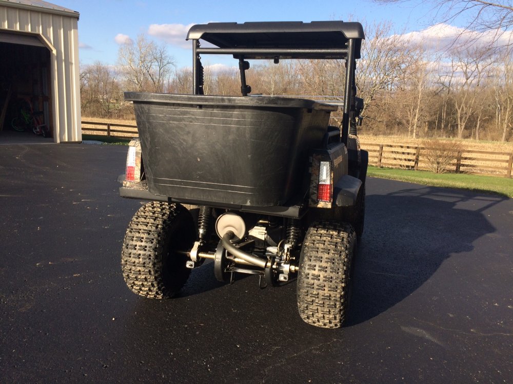

Hey all...came up with a trailer hitch design for the Sector 250. Very strong and easy to install. I know there are weigh limitations for this unit and good judgement must be used. I wanted this feature for using on the farm for pulling things like a small 4-wheel wagon, sprayer tank, down tree branches, etc...and it works great for pulling the grandson on a sled in the snow...it's a blast.
My attachments include a tongue / hook combination. A a long, swivel, eye- bolt for pulling wagon ( the swivel is to keep the UTV from tipping in case the wagon does)... My property is pretty level but I like playing it safe.
