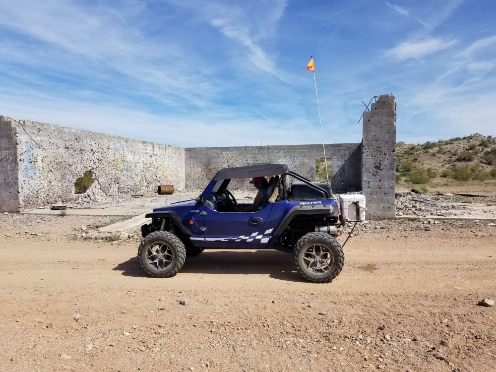

At almost 5 years I would have to say that's an understatement. I don't know what the outcome ended up, however I have a guy I know that I need to meet, my buddy says he has a 2300 ford in a T2 Joyner. I know what you can do with the 2.3 Ford, they use to graft them into VW buggies and Baja Bugs in the day when air cooled ruled off road. I assume the Reeper is a later year variant after Joyner USA folded?  I just bought my T2 in January after the wife's used $17,000 2019 CanAm 4seat 1000R  started it's life as a shop rat the second day we had it. It's not really that bad just a combination of bad luck and timing, after it goes into the shop I use mid April, it should be a pretty decent getter.  When it came to a UTV for me, I decided there were only two choices: Joyner, or Tomcar. As a retired mechanic who has done some interesting custom work, the car powertrain of the Joyner is a no-brainer. And as a Veteran the military background of the TomCar has it's appeal.   TomCar was founded by a veteran who served in the Middle Eastern Theater and considered the reliability of the common UTVs on the market dismal. They just plain look rugged too, saw a couple in Quartzsite while we were there.  My thought on a re-power leans toward a Mazda rotary, they're fairly lightweight, can make ungodly amounts of power, and being able to hit 22,000 rpm takes care of the top end problem from the super low gearing the T2 has, but I don't know if I want to drive a T2 over 100 mph.
Thanks Dave for your info and your service, much appreciated.  I sure would like to upgrade my engine in this oreion Reeper 2 seater, just hoping to find someone that has done it and can learn the do's and don'ts before i start.
It was my pleasure, Rebel.  I had to go look up the Reeper to find they are different from the T2 quite a bit. I see on the site that the Reeper is an 812cc Chery engine. to me that means it should be fairly easy to upgrade your engine by going to the same engine as the T2, the Chery 1100. They're available on Ebay new  and complete.  I don't know for sure,  but I would imagine the 1100 will bolt to the same transmission. Where you could run into problems though is length, logically like Geos the 4 cylinder is longer and the  length could prove problematic.
Not a bad looking rig, Rebel. You would think with as many of these engines as there are in the states in various different Joyners, Oreions, and whatever else has the Chery 1100 there would be performance parts available like cams etc. .  I'm sure we could send our cams to Somebody like Isky or Crower and have them reground to a more aggressive profile. From what I have read they don't turbocharge well, but can be supercharged and respond better to supercharging.  I made my living as a mechanic for years, and a parts guy before that, so I have to wonder what other parts will actually work in these engines. I haven't been in deep sand like dunes in my T2 yet, but I am interested in how it's going to do, sand may turn out to be the terrain that slows me down. the wife and kids all want to go to Sand Mountain, but we don't have paddles. I think the Mongrels on my machine might work ok in sand, but I don't know about the tires on the wife's machine for sand. Sand Mountain is nothing compared to the Algodones Dunes where I used to run in the 90s, but it is all blow-sand and it may mean paddles are a necessity.
