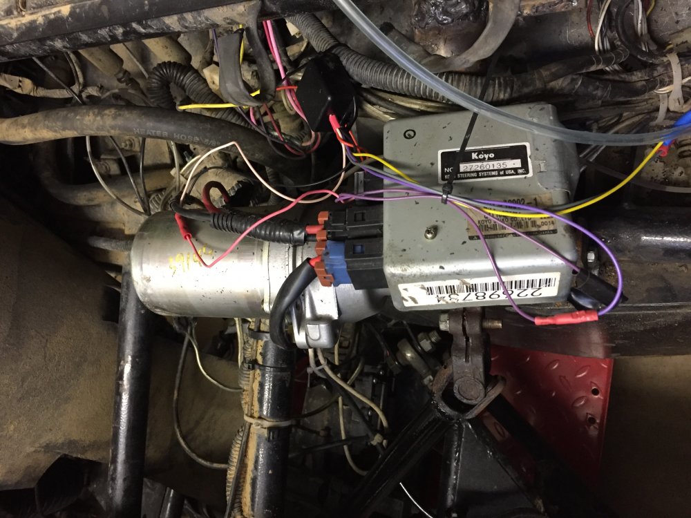

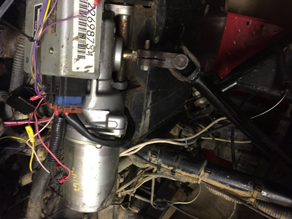

I made my own electric power steering for my Joyner trooper..I bought a steering column out of a 02 satern vue for $80 at a junk yard..then bought a wiring kit off of eBay for another $80. And made the steering arm...the wiring kit even came with a adjustable nob..
No it works great..just had to make a linkage for the power steering unit to the stock rack and pinion.. the wiring kit from eBay even can with a knob that I mounted on the dash to adjust how much electric assistants you want.... there is some utube videos about it to.. people have put it on hot rods and tractors.. you can put it on anything really.. you just have to adapt it to whatever you put it on..

Planning to add electric power steering to my 09 T4. Looking at YouTube, I have found that some of the EPS columns have remote mounted ECU and only require 3 wire hookup...power, ground and switched ignition. After 10 seconds, EPS will go into fail safe mode and supply good power assist, without the extra wires connected (or the adjustment knob.)
Thinking of trying a Prius or Corolla column...about $50 at the junkyard or $80 on eBay. Tobie1987 has done exactly what I plan to do. Any advice?
I used a calum out of a Saturn vue.. it works great but sometimes the electric motor wants to intermittent and not work..think of trying a different electric motor

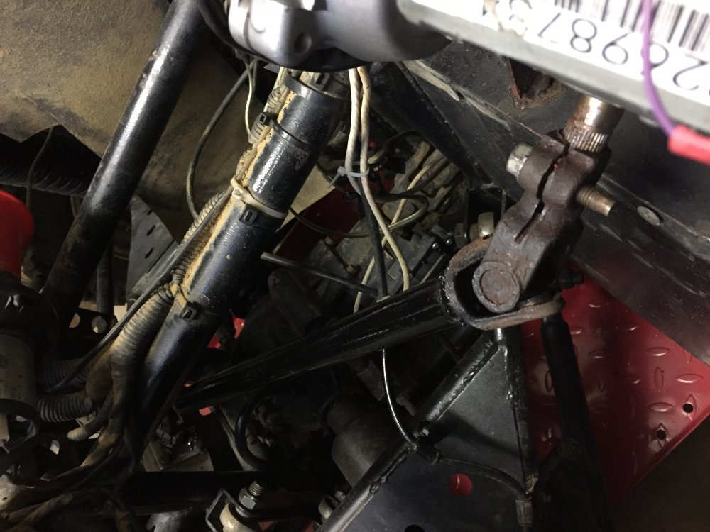

This setup works great on my T4...
I had been wanting to install power steering on my T4 for years so I went to the salvage yard last weekend and bought a complete column (minus airbag) out of a 2009 Nissan Versa for $125 with the ECU.
It was a fairly simple install. The long shaft that fits to the Joyner steering rack actually fit perfectly into the Nissan column. Had to weld up a U joint on the Nissan column to make it a straight shaft and fab up one simple bracket. Connect power and ground plus a switched 12v and now I can steer with one hand!
