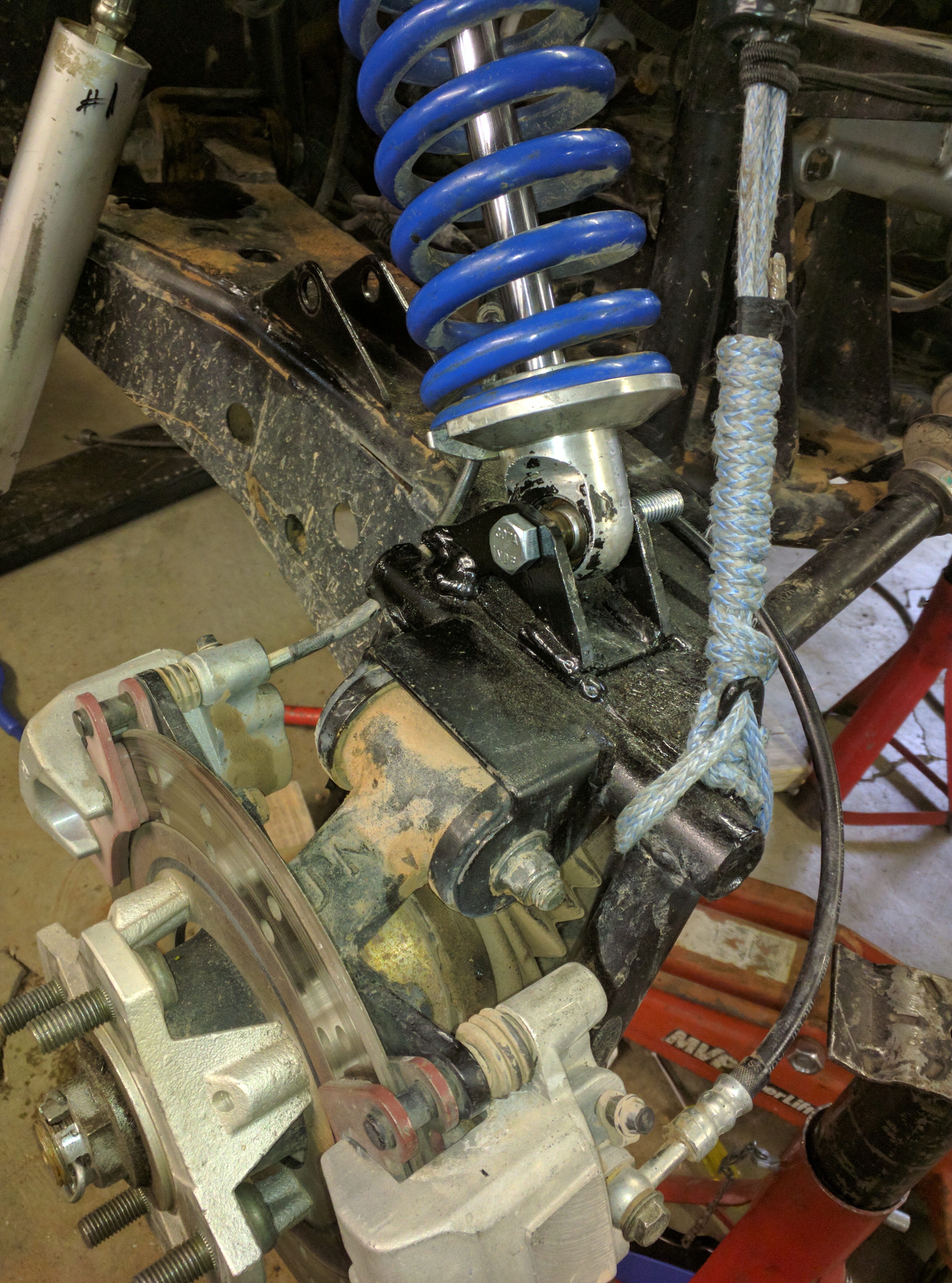

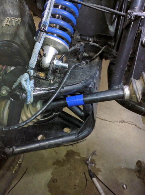

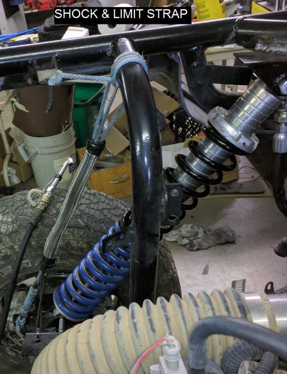

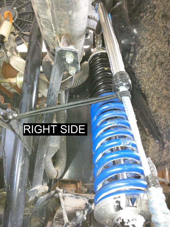

Here's a few photos of how I remounted my rebuilt F-O-A 2.0" shocks with 2.5 coil over springs (200# over 400#) (and it feels about right), I think this is an  8" 10"  shock, but I will check and if wrong, I'll edit the post.  The limit strap is Amsteel-Blue Rope,(http://www.go2marine.com/product/38345F/samson-amsteel-blue-rope.html?WT.srch=1&WT.mc_id=gb1&utm_source=googlebase&utm_medium=productfeed&utm_campaign=googleshopping&gclid=CjwKEAjwvYPKBRCYr5GLgNCJ_jsSJABqwfw7GsayfIaI2VFV5AJMJAD1Qoe1Wojhr9ASGTsHv9qK-xoCFXPw_wcB ) so I'm sure it's strong enough!
I'm still doing finishing up things,painting, tightening and checking and need to put the deck back on and test some more.
Edited by Kinarfi

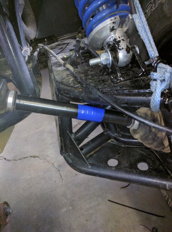

I measured the shocks, I had 9" of shaft showing and the limit straps are holding about an inch inside, SO! they are 10".

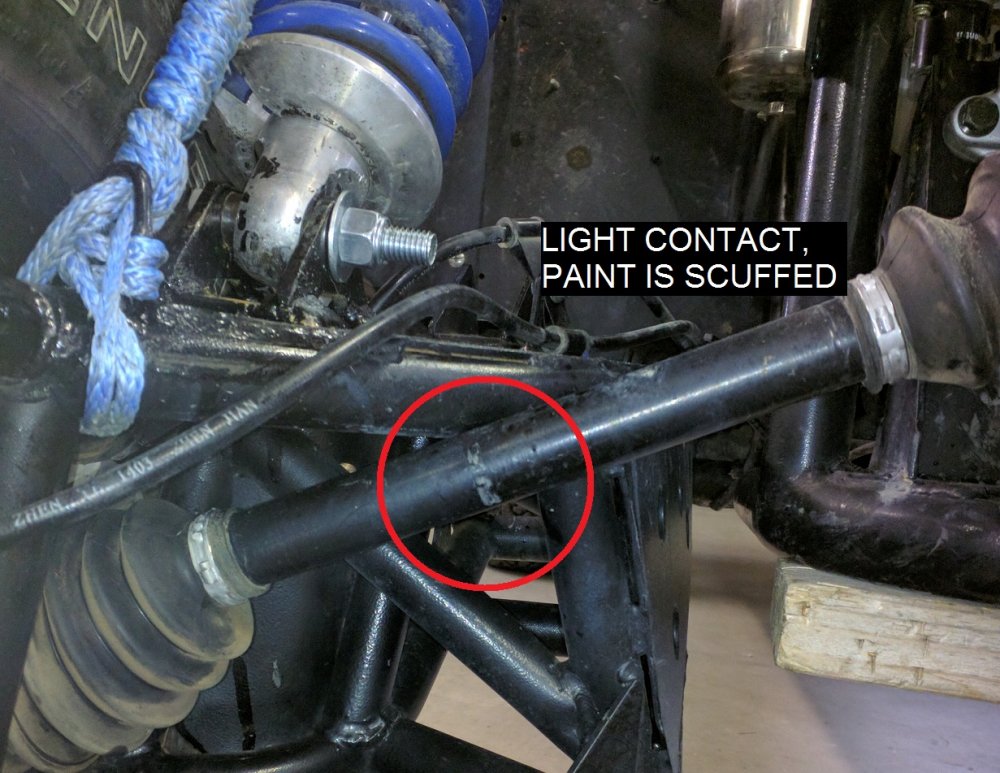

When I set my limit straps up, set it so I have about 1/8" separation between axle and swing arm when the wheels are off the ground, then just to see if they ever make contact, I put tape on the axle and as long as the tape looks good, no contact was made.

These shocks were on the yellow 08, and the seals were blown, when I bought the blue '15, they took the stock shocks off and gave them to me after putting the yearbens on, when I sold the yellow '08, I took the F-O-As off and put the new stock shocks from the blue'15 on it and kept the leaking F-O-As as spares, it's a season or two later and I need to replace the Yearbens, so this is where I'm at now.
The placement of the lower shock mount was by MY choice, my theory being that all the forces down on the swing arm should be as close to center of the wheel as possible to reduce the tendency to cause the swing arm to roll from rolling, as it did on the yellow'08 and I had to change the right swing arm because the right side tire had a bad inward lean at the top, it may have come that way and I didn't notice.
The upper mount was because I put the lower one back too far, the shock is compressed about an inch with the limit straps, So I have about 9 inches of shock travel and without taking the springs off, I can't be sure of what the wheel travel is.
As for a good ride, I think I hit my target pretty good, went for a ride yesterday and when I came to a pretty good whoop, I didn't back out of it or any thing else and was very please how the Trooper took it, so was the wife.  I have 200# 10" over 400# 10" springs and it's been so long since I messed with the valving washers, I'm not sure how I have them set.

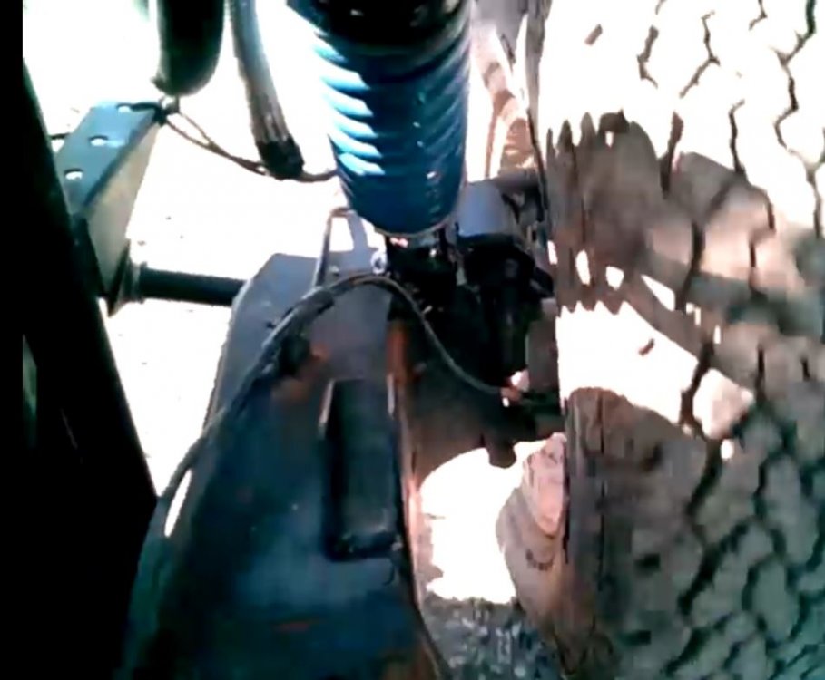

I uploaded a .AVI video here, it's 10 minutes of the wheel going round and round and the shock going up and down.
VIDEO_2017-06-13 18-04-48.avi
