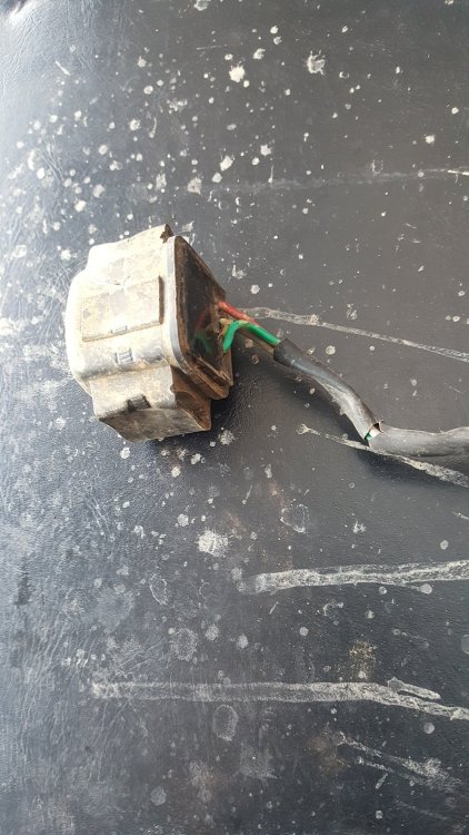

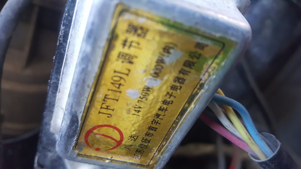

i have attached 2 pictures because i am unsure of what these 2 objects are in the pictures ..

The 2 pictures are signal flasher with pig tail and the other is voltage reg.The first thing to do is call me.It is 2 complicated to explane buy  email.
