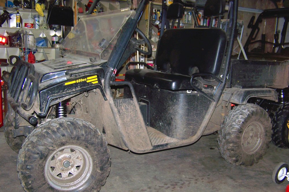

I don't know the exact year but about 7 or so years old, Trail Wagon, with 653 Subaru engine (which is good). It's not made to go fast and you don't want to, steering is sloppy. For off road on bad washed out rocky/muddy trails it is slow but gets through it all. A shame there is no guard for the rear transmission with alloy housing. If it was not for the lack of parts and/or expensive assemblies  I'd keep it.
The seat is not original, this one softens some of the bumps. Original seats have soft foam that sinks to the plywood base when sat on providing NO cushion.

I did find a part that worked, a Polaris gas shock. Had to make the thread diameter smaller to fit the mount.  Landmaster only sells the complete strut assy. and the left side they are out of. Stut assy. is $380, way too much when you just need the shock. Bought the shock for $100. You can see it in the photo, the only "clean": part.
