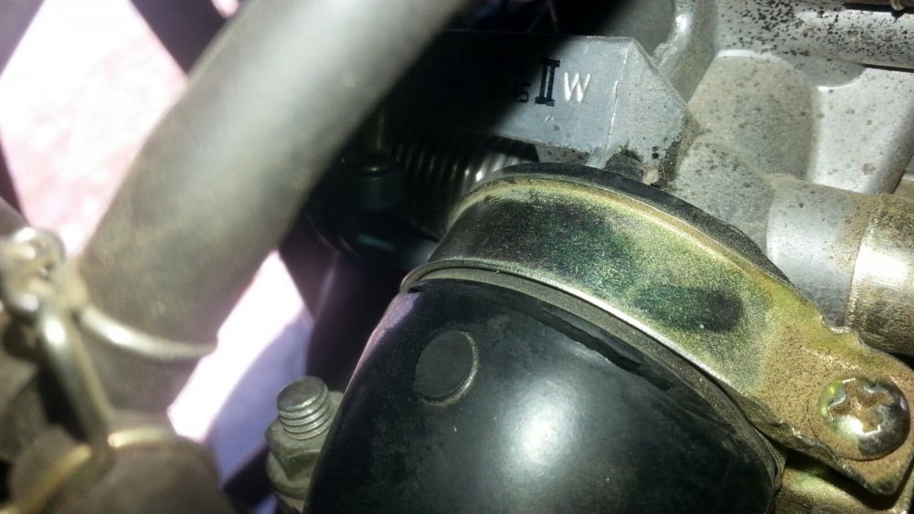

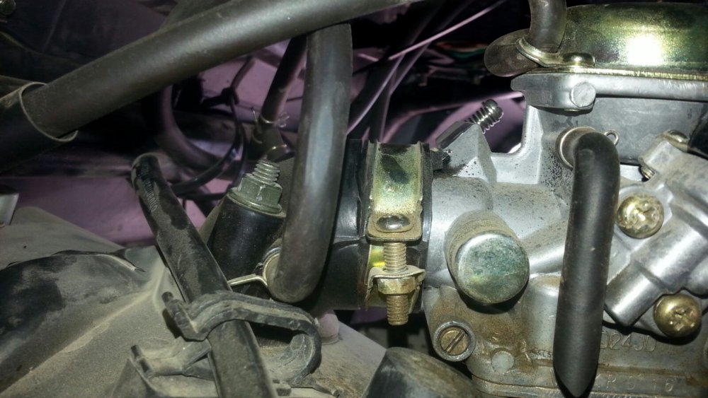

have since discovered a split around the intake manifold where the carbs mounted on the engine. Seems when the engine revs theres a lot of engine pivoting & movement opening up the gap under load. Will get that changed tomorrow and hopefully report back with good news.

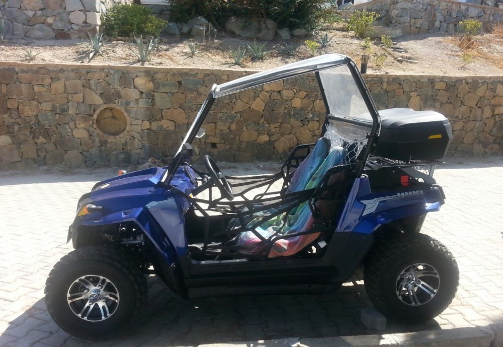

Update on Chinese UTV Cazador
Running well now, starting ok.
Performance specs are for your reference.
2 passengers cruising 30mph max 34mph downhill and 20mph uphill

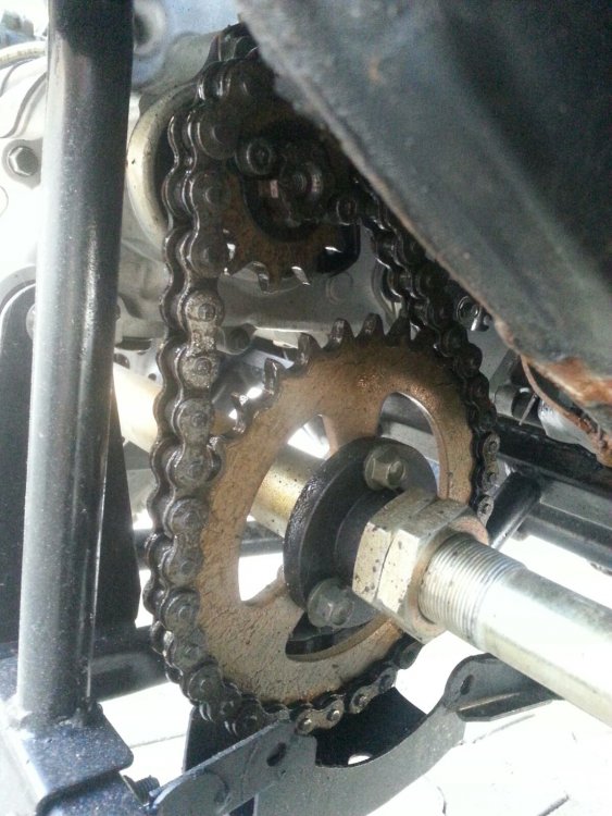

Reversing has tendency for chain to jump.

Shockers upped to 3rd notches back and front, rides firmer and chain adjusted but needed to sash clamp the shaft to get it moving. the bolts are too soft and one thread stripped.
Sprocket bolts loose and a few others including castellated wheel nuts and shock mounts.

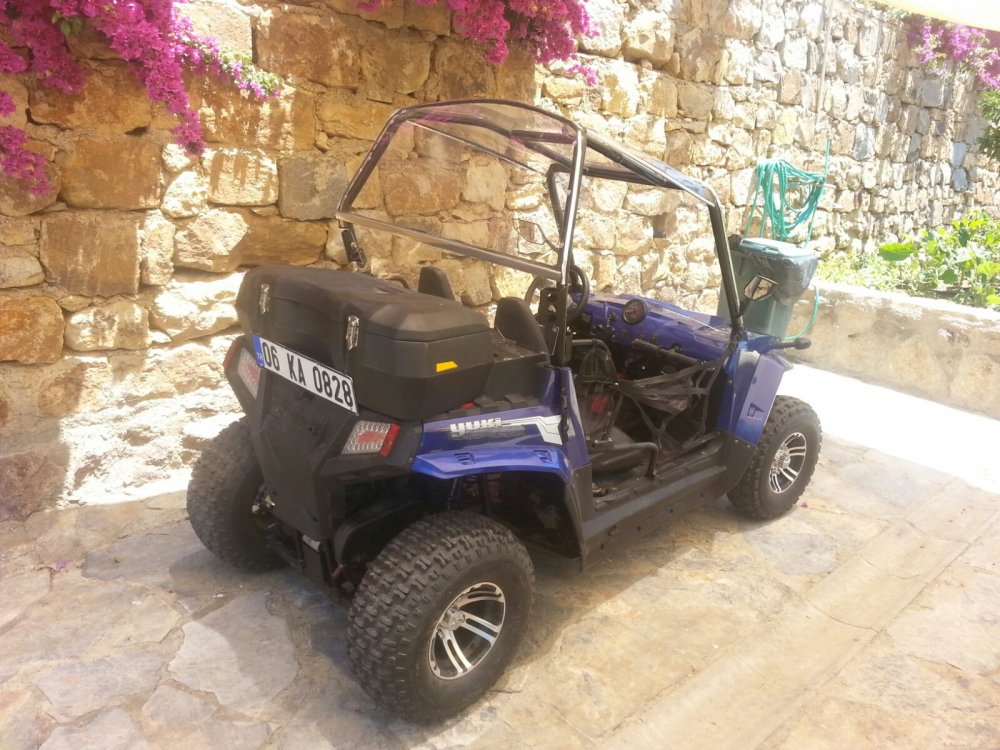

Update:- Headlights now way too low and need adjustment. Remounting Back storage box higher so can access the parcel shelf and maybe fit extra spotlamps to sides above mirrors if lights are inadequate.
May have to adapt windshield as a fold down as get dazzled by lights at night and have to illuminate lamp and indicator switches.
I've just finished upcycling an old clothes rail to raise the cargo box and can now store gas, jump leads, Slime and pump underneath and covered with webbing to hold all in place. I was always looking at the wasted space with the original mounting and it had been put on off centre.

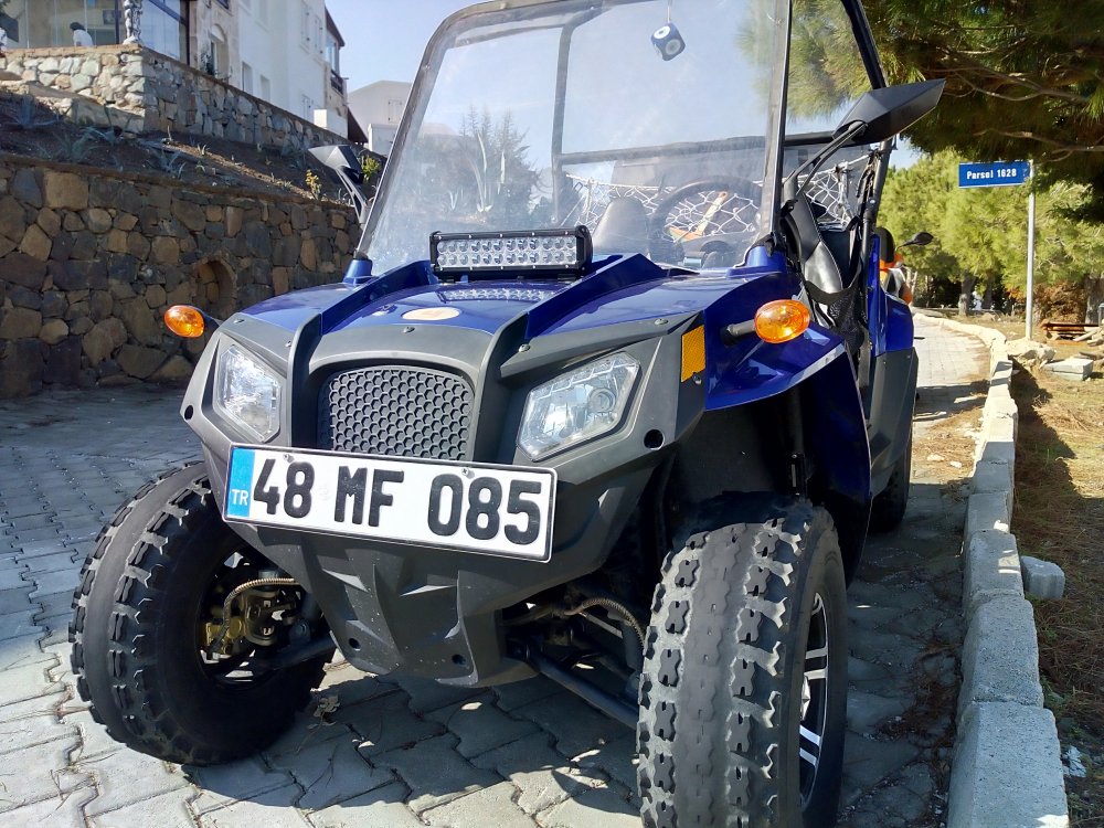

Light bar mounted and also reverse and interior LED's with a new fusebox mounted under dash with a centre switch plate. Very impressed with the light bar but wish i could fit stalks on steering column to dip, flash and indicate etc. but hey ho.. its doing well.

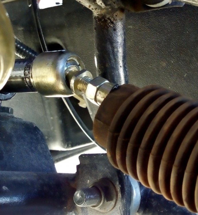

Steering rods were both loose through vibration and hence steering was well out of line. Soon corrected with string and tape rule, adjusting tie rods accordingly. also the bolts on the knuckle were loose.
I've opted for dry silicon chain lube on all steering ball joints as rubber boots all rotten and grease attracts dirt so Castrol lube it is.
