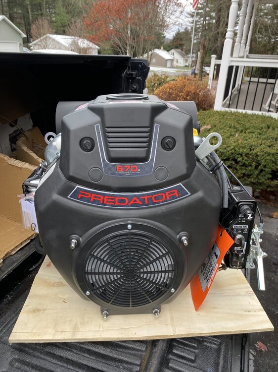

WX is keeping me in the house for now.  One thing that was obvious from the start is the exhaust has to be reconfigured to fit the machine. Search around the local marketplaces.
I found my Predator on offer up for $100 bucks brand new.
